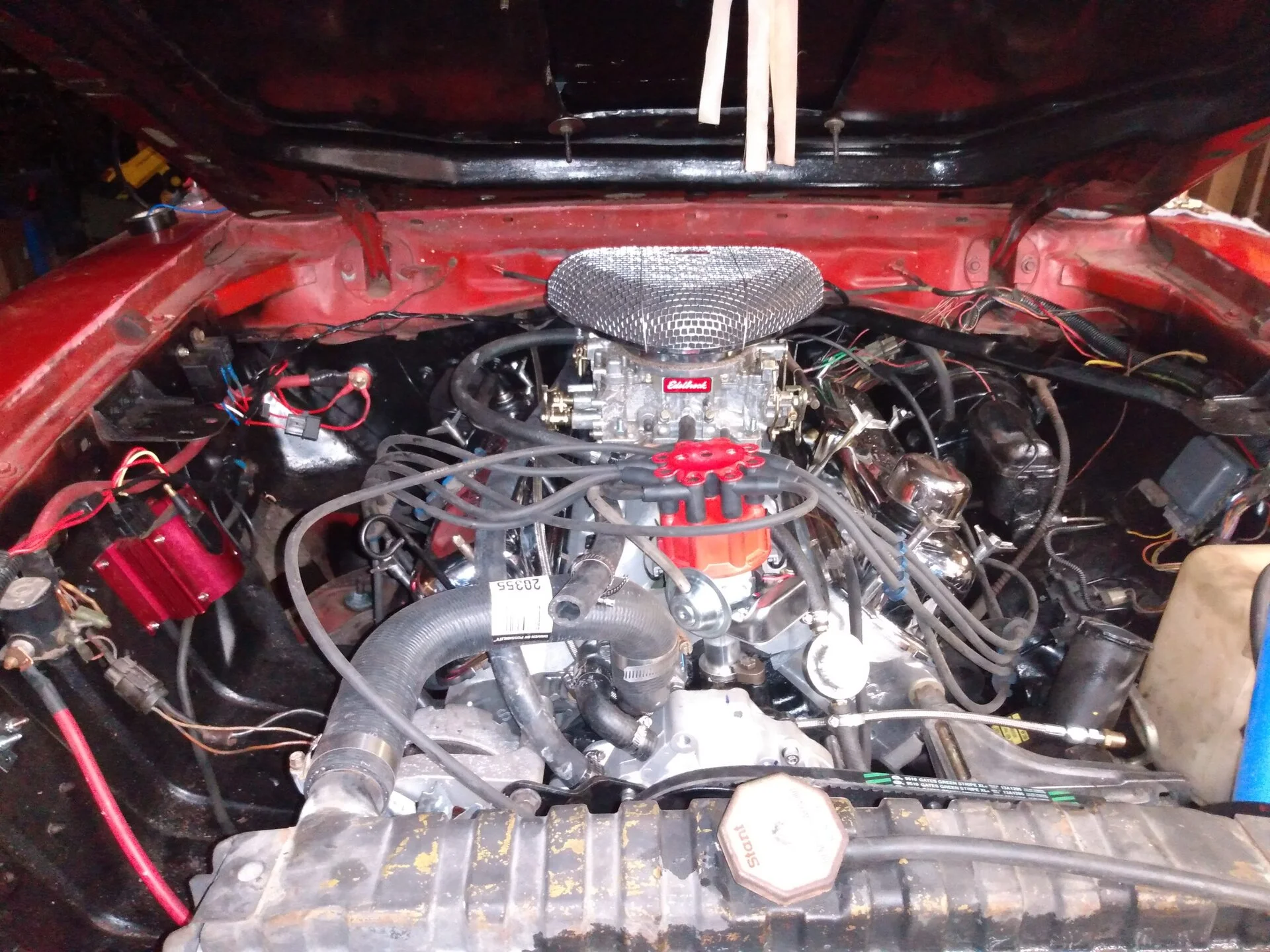

When it comes to the alternator, upgrading from the Ford externally-regulated stocker to something better requires wiring. I run a Chevy 1-wire on mine, I think it's 65-amp. It handles everything but the initial surge of my Flex-a-Lite Syclone fan just fine (idle stumbles for about a second when the fan initially starts). That's while running the MSD EFI, MSD ignition, and electric fuel pump.
PowerMaster makes a 1-wire, 100-amp that is a direct-bolt-on physically for Ford now, but you'd still have to do the wiring.

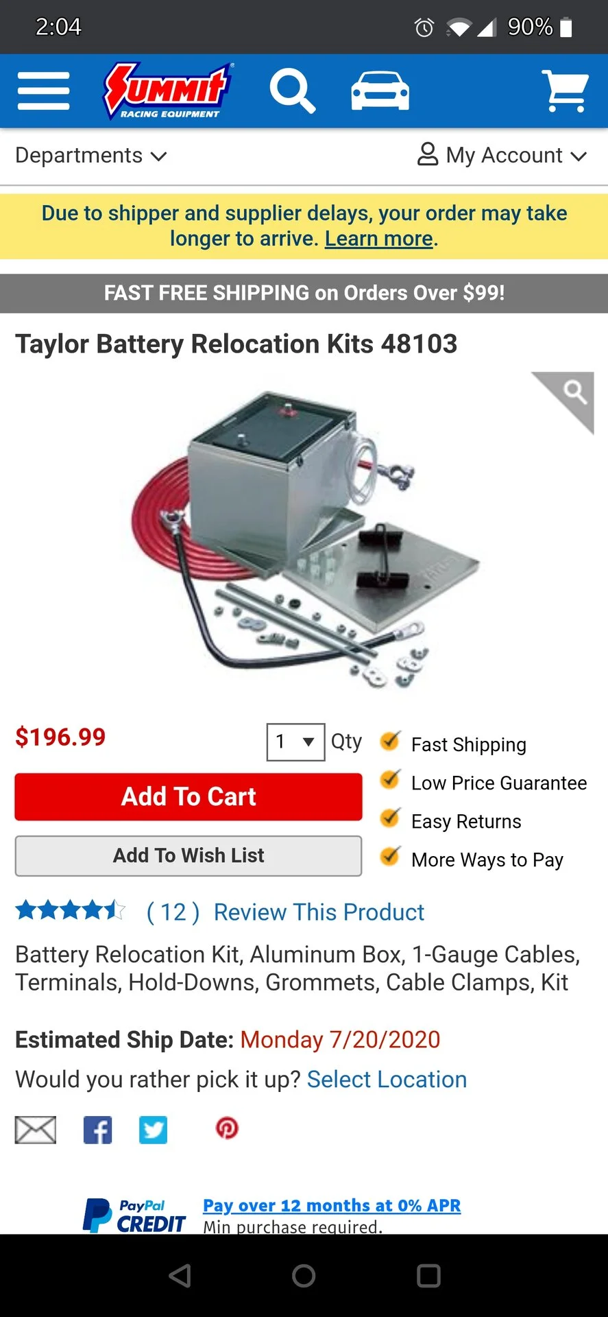

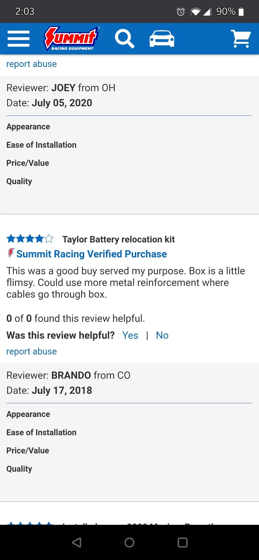

Been window shopping, looking at an Optima Red Top as far as a battery is concerned. And I was looking at battery boxes on Summit, really leaning toward an aluminum box, but some of the reviews I've read say they're flimsy.
If it's going in the hatch, I think I'd want something fairly sturdy. Maybe a plastic box would be better?

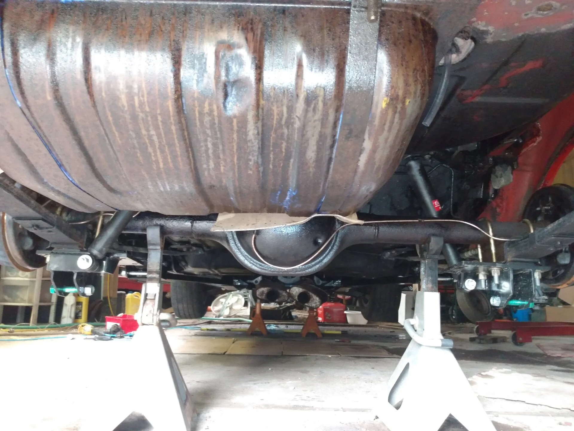

Too hot in there for a battery hence why they had to run a cooling port to it. With a hatch model, the concerns are obvious, so as long as it is a sealed battery and bolted down with heavy enough hardware to keep it from becoming a missile it should be fine. I wouldn't rely on just the box being bolted down though, a sturdy cross bar and bolts/redi-rod 3/8 minimum clear through the floor with a backer plate. under as well...

The Taylor box is kinda flimsy but not unexpectedly for an aluminum lightweight box. Once it's bolted together it does it's job fine.
