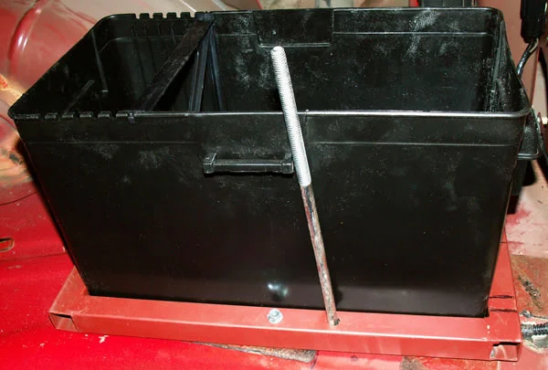

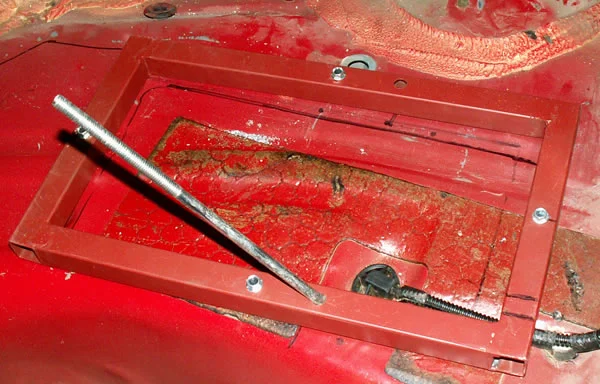

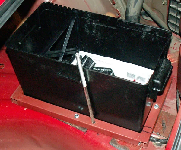

I ordered the Summit kit. Then decided our trunks are tiny. The location I'm using SHOULD be fine for changing the battery, but I stopped by the old man's house and we built a tube frame for the box. This way I can unbolt everything and remove it, if need be. Plus it'll have more than just the J-bolts holding it in.
Oh and because I haul my extra pair of wheels to the track. I'm painting the inside of my trunk, and will cut carpet to go in the spare tire holder.
I'm still debating on larger wire, and not sure on running it inside the car or underneath.
