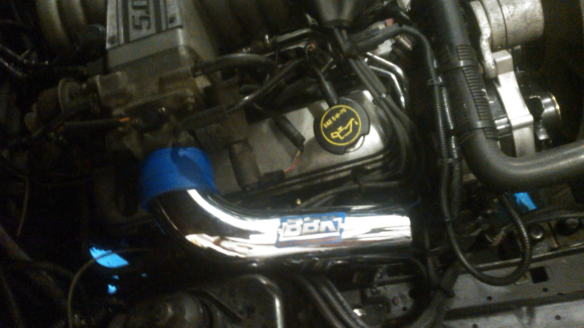

My problem is that it won't sit flush against the tb and still clear the shock tower. I thought a 90 degree bend was in box for the straight part, curve goes into fender, it's not. Just two straight rubber couplings. Does it just sit cockeyed and rub against shock tower? can't be right?

I don't think it a problem, the reason I made the comment because I think you are talking about the placement of you tb or cai, it was not clear to me what didn't fit and not enough info on what was hitting you shock tower, post a pic of the problem.
I have a c&l tube between the maf and tb and it almost hits at the turn, I can adjust the couplers to barly miss.

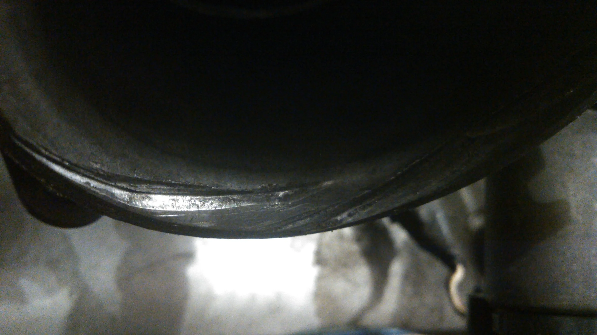

It's sitting crooked inside grommet wearing a groove in tb like the old one was doing. If I make it flush to tb it won't turn down, hits shock tower. Odd no matter how I'm placing it, it hits the shock tower. Just needs a few more degree bend.
You may hate to do it but I see no reason why you can't trim the tb end of the tube an inch or maybe less for clearence. I'd make sure your motor mount on that side is not mushed a little, my motor mount pads are slotted (stock k member) maybe allowing for some adjustment, tilting the motor slightly may give some space.
