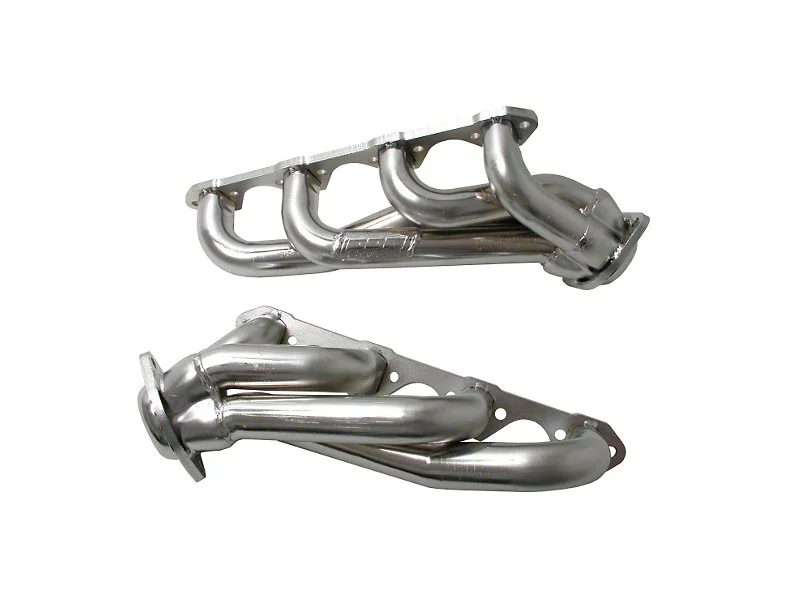

My 85 GT came with an H pipe and dual Flowmeters, wich sounded great, but I had to get rid of the stock exhaust manifold. So I got the BBK shorty's for an "easy" bolt on Application. So the headers bolted on to the block fine, but I can't get the collectors to seal.
When I pulled off the originals, there wasn't any type of donut or gasket between the pie and the collector, so I bolted these straight.....leaked like a MF.
I can't get the pix in order, but...
#1 shows the header collector

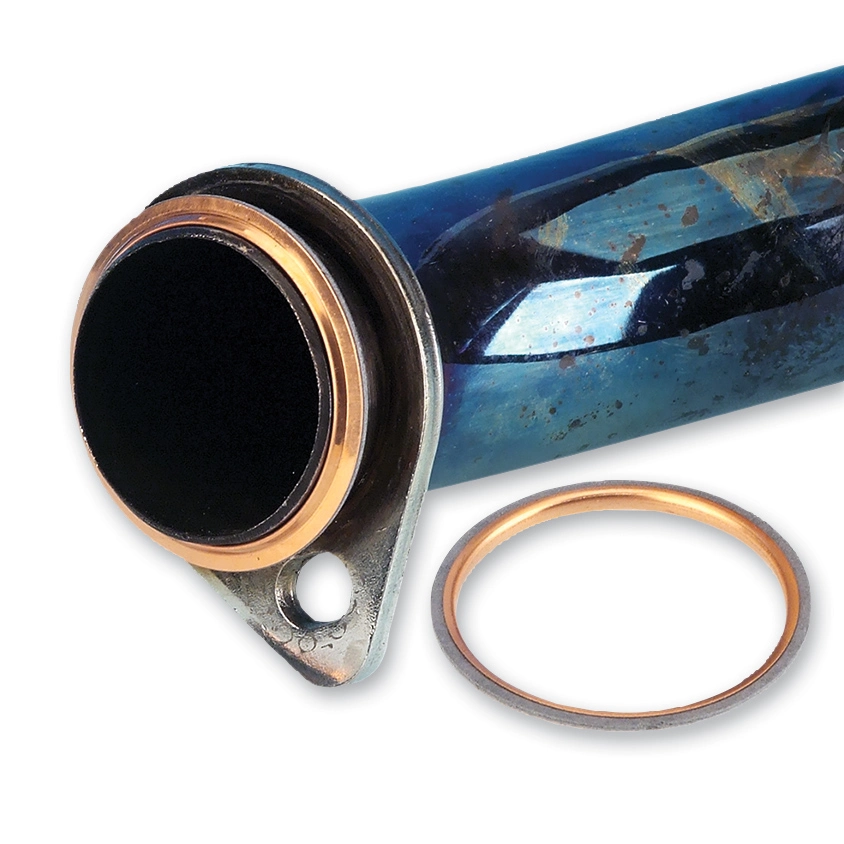

#3 shows what the pipe flange looks like and the ring that I installed

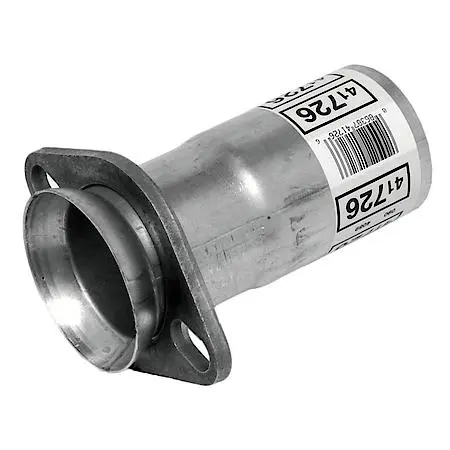

#2 looks like a similar ring as pic #3, but has a flat spot...should I try this one?

That looks like the header gasket for my harley.
no gasket required on those pipes that I know of.

Dang, now I'm just hoping I didn't stretch out the end of the pipe that the ring sat in. I'm going back under!
