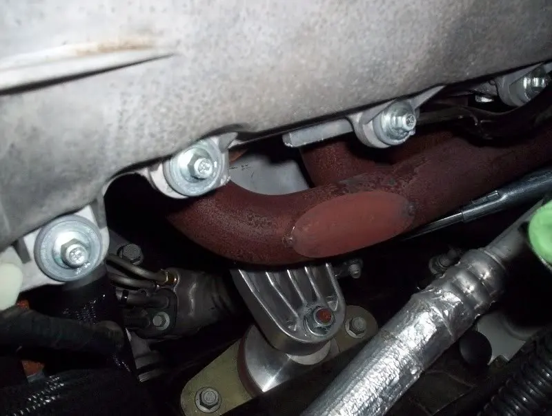

stainless can rust as well. the better grade of stainless is more resistant to surface rust, while the cheaper (i think its 304) can have surface rust. stainless should not rust through, but surface rust is still possible with some stainless grades.
i am not 100% sure because i dont have first hand experience with ceramic coatings. here is a pic of a stainless JBA header.....
Background
409 is a titanium stabilised ferritic stainless steel. Although regarded as a general-purpose chromium stainless steel the primary application for Grade 409 is automotive exhaust systems. Its applications are those where appearance is a secondary consideration to mechanical properties and corrosion resistance and where some weldability is required.
********snip......*********
Corrosion Resistance
Grade 409 resists atmospheric and exhaust gas corrosion. A light surface rust will form in most atmospheres; this rust retards further corrosion but makes the surface undesirable for decorative applications.
i got that info from this site. http://www.azom.com/Details.asp?ArticleID=969
409 is the less expensive stainless, while 304 is the nicer, more expensice stainless.

Thanks for the info bigcat. It sounds like with any kind of header, unless you are willing to deal with some amount of rust you need a coating of some kind. I don't really worry about surface rust so much as having them rust through. Surely BBK would have some kind of warranty on that don't you think?
