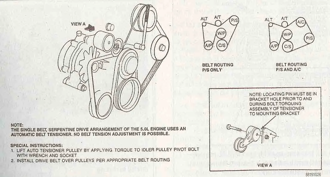

I have BBK aluminum under drives on my SN95. No problem with the stock belt at all. The belt tensioner arrow fell withing the acceptable range markings on the tension's face.
Not that this should matter, but it might. I still have A/C, PS and the smog "air" pump installed.
It is possible to misroute the belt and make it appear like it can't fit. I did that at first. Eventually, I got the correct route and the stock belt fit just fine.
Sometime a little RTFM (Read The F-ing Manual) helps. It helped me in this case.
