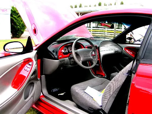

OK here's my interior.. I pried out the panels, sanded them with fine sandpaper, cleaned them with rubbing alcohol, then sprayed them with paint from autozone. It took quite a few light coats, if you do heavy coats you screw it up. Then a few coats of clear gloss over it when you are done. It took me quite a while, but I think it looks all right. It's not professional quality, but it's good enough for now.
Took me too long.... I screwed up the original door panels by painting them too heavily, got run marks all over them, so I had to go buy new ones. Overall about 2 weeks, and during that time I was cruisin around with my radio, cd player, and power window switches dangling around by their wires. I'm glad it's done, but would I do it again, by myself? Probably not..
