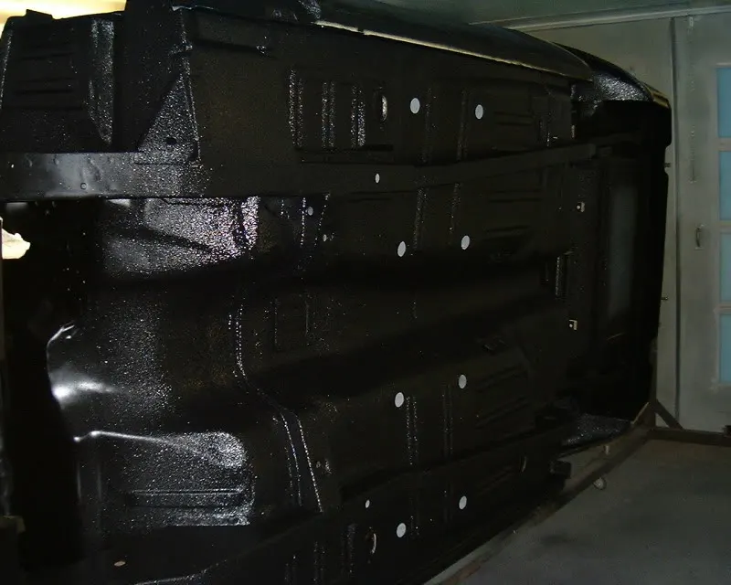

I have used SPI www.southernpolyurethanes.com bedliner on my 68 Coupe and 67 Fairlane.

Rusty428cj - that looks awesome! I am also planning to use bed liner as well.
