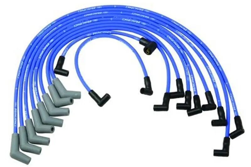

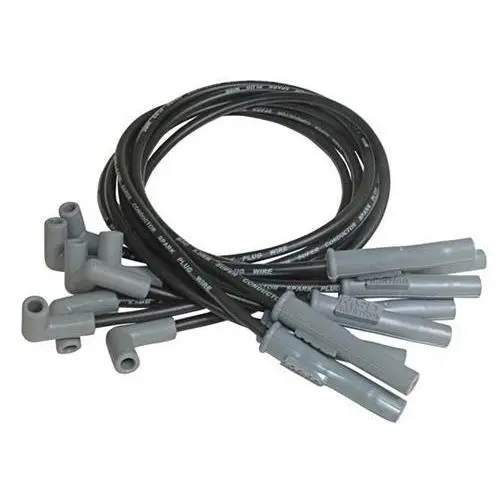

Carburated 79-85 5.0 wires have 90 degree boots
EFI are more like 45 degree or straight usually
Unless you can get your exising sleeves to slide down, for 90 degree wires you can get either these
or these
or these
Thank you. I’m gonna see if I can get these to work before waiting any longer to get new stuff delivered. I just want to drive my damn car already!
or these
Which of the two do you prefer/recommend?

Best wires for a fox body v8 are LiveWires, however I have been using the FMS wires on these cars for 25 years . Some people complained about them arcing but I have never had that issue, I've never had an issue with the FMS ones. They are on my 500hp car and my stock 225 hp car
