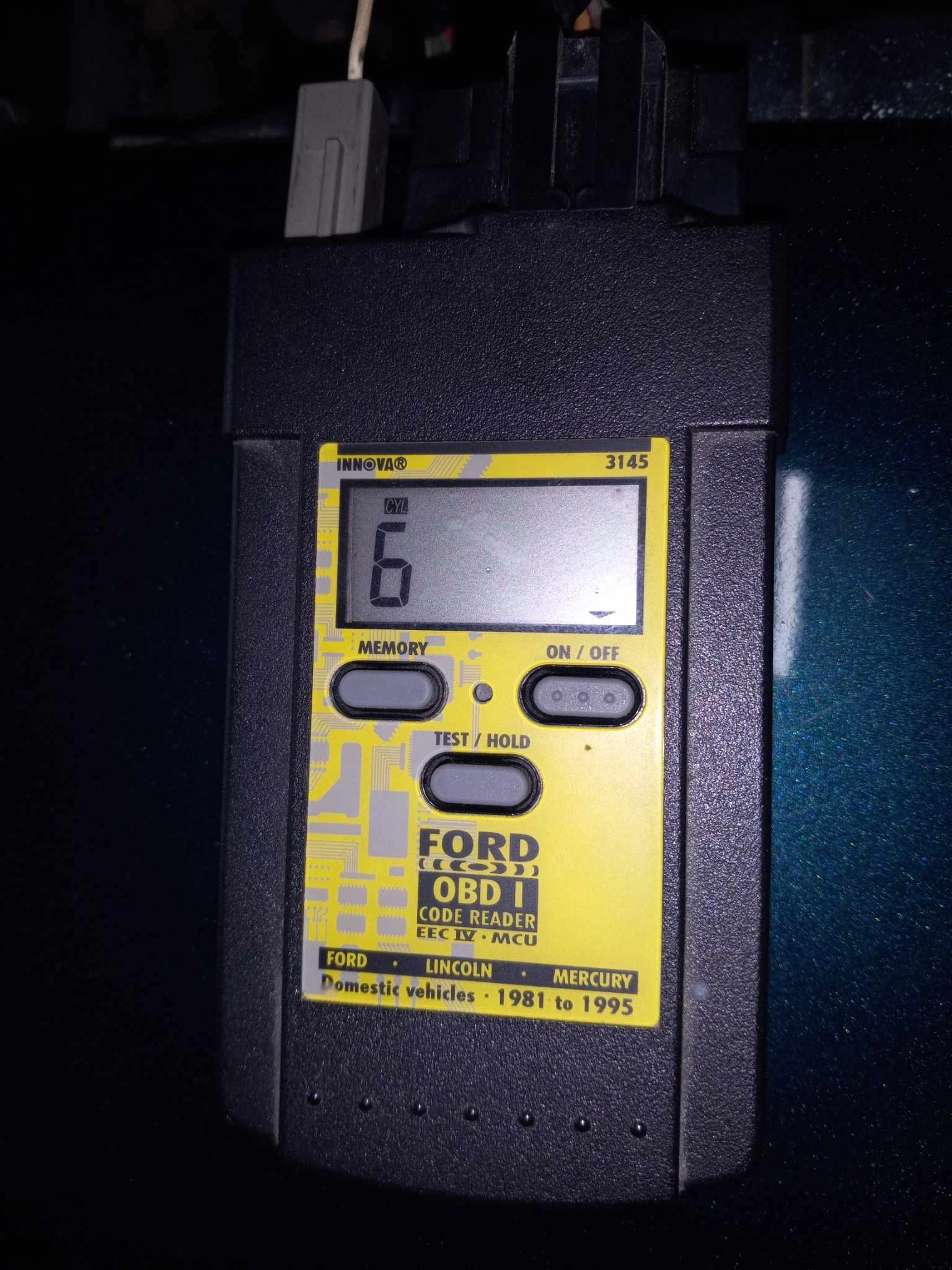

Does anyone know what code 6 means on an OBDI scan? Yes, just 6, single digit. I get that code every time I run a scan, not much information out there on a single digit code. I even resorted to asking AI and it suggested it was a TPS (throttle position sensor) code. I did hook a voltmeter to ground and signal on the TPS. Car idles at .9 volts and around 4.7 volts with throttle fully open. I have been having issues for years with the car sometimes jerking and trying to stall when going from park/neutral to reverse/drive. Today it was just completely cutting off when going into gear and even for the first time starting to idle rough for example, sitting a light and trying to stall. I have tested and replaced every vacuum line in the car, my PVC hoses were rotted out in some places and my exhaust connection to my EGR was broken. I did have an issue where the car would not run after it was warmed up. I had fixed all of that and was just left with the one issue of the car idling down to around 400 to 500 RPMs when going from park/neutral to reverse/drive. Which is an issue I have had with that car for almost 15 years!! I am at my wits end and about to sell this 94 and put the money towards my 66. Just it is my first mustang I have owned for decades now. Another think I have noticed, is the voltmeter in the instrument cluster will jerk down randomly at times??

I really needed this to be a new thread, since it's a new problem.. And yes, I would normally agree all codes for a mustang with an OBDI system, starts with 11.. But I assure you, I am getting 6.
Can you walk us through how you are pulling the codes and at what point you get a code 6?
I hook my OBDI (81-95 Ford specific) scanner up to the harness under the hood near the passenger firewall, start the car up, turn on the scanner and hit "test". The scanner will cycle and test all systems while the car is running. The first code I get is 6, followed by the code that tells me my overdrive is on and my parking brake is set. So, I know the tool is working properly, plus I get code 6 with another, cheaper code scanner.. The computer keeps kicking a code 6..
Just in case anyone doesn't believe me. I also read the manual that comes with this scanner front and back to make sure it doesn't display any single digits at any time during use to maybe communicate anything else besides OBDI codes. Also, the manual itself doesn't list any single digit codes, it only starts at 10 or 11, forgot which one.

So, after some more digging and being able to actually read the icon on the scanner above the "6" with the enlarged picture.. Guess my eyes are getting old.... This scanner displays the number of cylinders when starting a scan. Which is very confusing to me, since the car is a V8 302...
So you are doing KOER (key on engine running). Is the motor up to temperature? What about KOEO (key on engine off)? See Post #3 in the following with regards to 6 cylinders:
Thank you, I did see others on F 150 forums with the same issue of a scanner showing 6 cylinder when it should of been 8..
