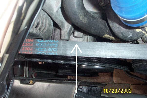

THe notch should be between the two lines...If the notch is to the right of the right line...the belt is too long.
If the notch is to the left of the left line, belt is too tight. Having the notch in the middle means the belt is just the right tightness to allow the tensioner to adjust accordingly as the the pulleys spin.
RC
