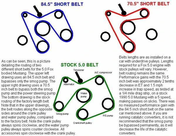

I did a search and couldnt find a certain answer. I need the right size belt for the fms ac delete that relocates the ps up to where the ac was, no smog pump at all, 3g alt(which is in the same location as stock so i dont see what this matters), and stock pullies not underdrives. Please let me know so I can get the right one. Thanks
A cheap, reliable method of measuring is with a cloth dressmakers tape. They are flat and totally flexible, with mm on one side and inches on the other.
Available any fabric shop or dept store, incl WalMart.
Just wrap it around the pullies like the belt goes and
read the length where it meets.
http://www.fordmuscle.com/archives/2000/02/shortbelt/index.shtml
