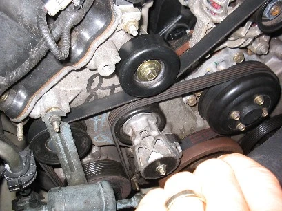

Here is a pic of the front of my Stang. I hope it helps. p.s. My tensioner is removed by taking the (1) center bolt out.

Thanks for the pic... definitely not the tensioner that I have. Did you remove the bolt from the automatic tensioner, or the idler pulley? It looks like maybe the idler... ok, there's an obvious thought, remove the idler.
