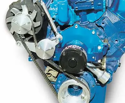

Hey guys I have a problem. I just got an electric water pump for my car and the only thing I am running off the belt now is the alternator. My problem is how do I route the belt now. I have an adjustable alternator bracket that keeps the alternator in the stock location but eliminates the stock tensioner. I am sure other people have the same setup that I do now. So if you have a solution for me, or help it would be greatly appreciated. Pics would also help a million.
Thanks,
Dave

I assume you have an '88 Fox model so here's your solution:
FORD SMALL BLOCK SERPENTINE BRACKETS
5.0 SERPENTINE ALTERNATOR DRIVE KIT
For Electric Water Pump Setups
Meziere Backplate Style, CSI and Aerospace Water Pumps Only. Will not work with 94-95 Mustang, 89-93 T-Bird/Cougar and 96 Explorer and newer timing covers.
Kit includes:
Performance crank pulley (aluminum) Alternator bracket and tensioner rod, Idler pulley Alternator pulley (aluminum)
Part# 30065 - 5.0 (302c.i.)
Part# 30060 - 351 Windsor
Opt. Alternator fan #221
Installation instructions for #30060 #30065 electric water pump bracket kit
