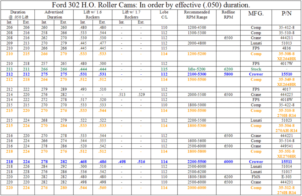

hi, i'm building a 87 mustang GT speed density (no mass air) stock short block E7 heads ported with bigger valves 1.94 intake and 1.55 exhaust, 10.3 cr , explorer intake, 2.5 complete catback, manual trans, 3.73 gear, 1.6 rockers...
What cam can i use? of the shelf...
but i need to get an other cam because the stock one has one lobe gone because of one tappet bearing so i need a good aftermarket one...

The colored cams on this page have been proven to work with speed density EXCEPT the very bottom 276HR cam.
