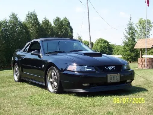

I have an 04 vert too. Originally I installed the Eibach Pro-Kit, I had it on for about 2 months but sold my springs to a friend because I wanted a lower stance than the Pro_kit offers (1.5 inches). Now I have the H&R super sports which lowered the car 2.0 inches in the front and about 1.75" in the rear. I feel that the ride has actually improved over the pro-kit however due to the fact that its lower you have to watch for speed bumps and angled driveways and parking lots. O'well small price to pay for that great stance.
Here's a pic with H&R's
