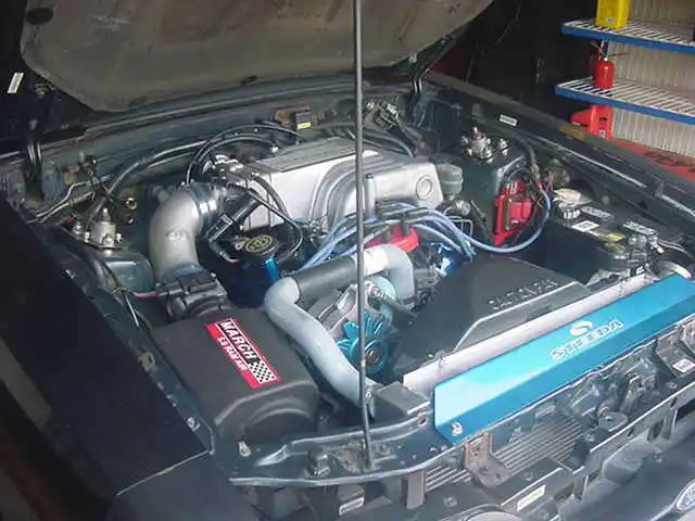

What you'll need then is the March Ram Air. It uses an in bay conical K&N filter but routes the air in from the fender via a duct.

Maryland Stang, that intake setup looks great! Modular 2v, i just installed the 80mm pro-m with 42# injectors and the car started right up, idles very well, has great responce. I will say that if you have a passenger side mount blower, installing the big pro-m is a little trickey as i had to remove my blower to squeeze in the maf, i'll let you know if any problems occur - we had rain today so i left it in the garage.
