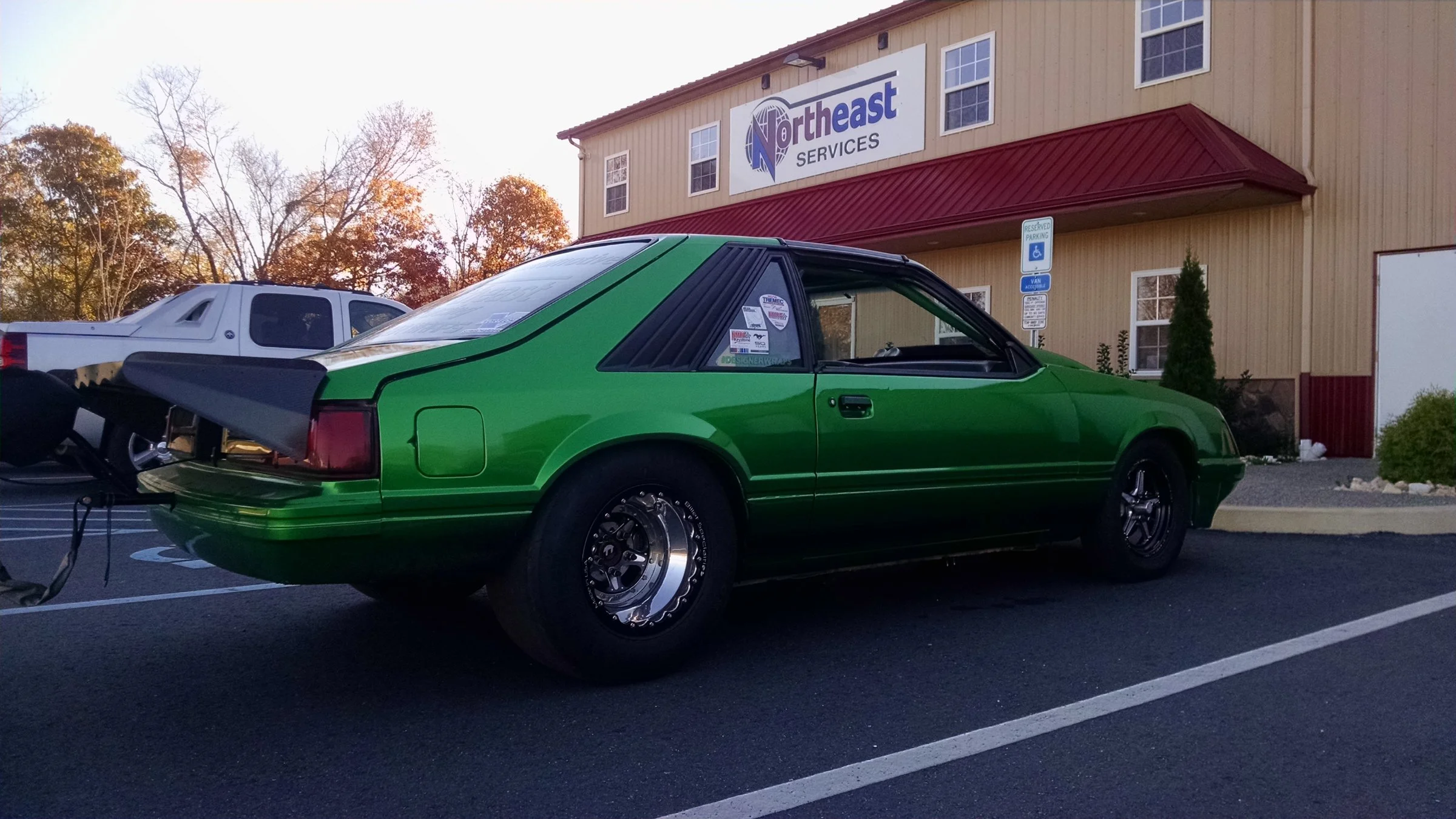

Usually it's a trade off, do you want the best off the shelf spring or the better stance? Sure, some guys have cut drag springs to get the stance they want but that is less than ideal. Personally, I prefer to switch to coil overs as you can pick the required spring rate and pair that with a good set of adjustable shocks and struts. While my example may be a little extreme, we've been 1.17 60' on the back tire and the car sits killer in my opinion.

Note: Could we get the car to sit lower? Absolutely, but that would cause the suspension geometry to be upset. We want to go fast while we try to look good :)

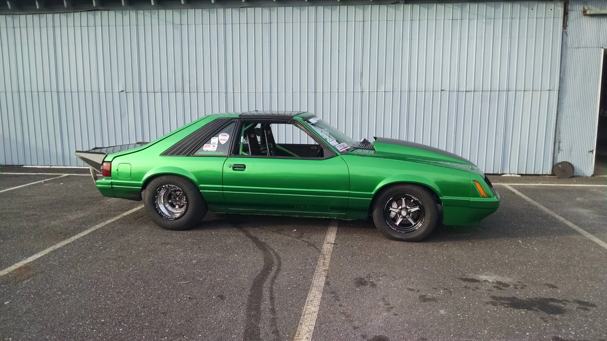

Team Z actually started making their own rear spring. It lowers the rear slightly over stock but isn't as drastic as say an Eibach sport spring. @TOOLOW91 and I both run them. I haven't any track times since install though. Jeff is in the 1.60's 60 ft time range if memory serves. I'm running a coilover 14" 175# front spring(purchased from Team Z but it's a hypercoil spring-same as MM sells) and I run strange adj struts and shocks. Team z used to always recommend the stock springs but since getting involved with manufacturing their own..marketing??..they recommend theirs. I know a few cars that are in the 1.teens-1.20's with said springs. A lot cheaper than a rear coilover setup. Just saying. This is the ride height on mine with 275/40 rears.

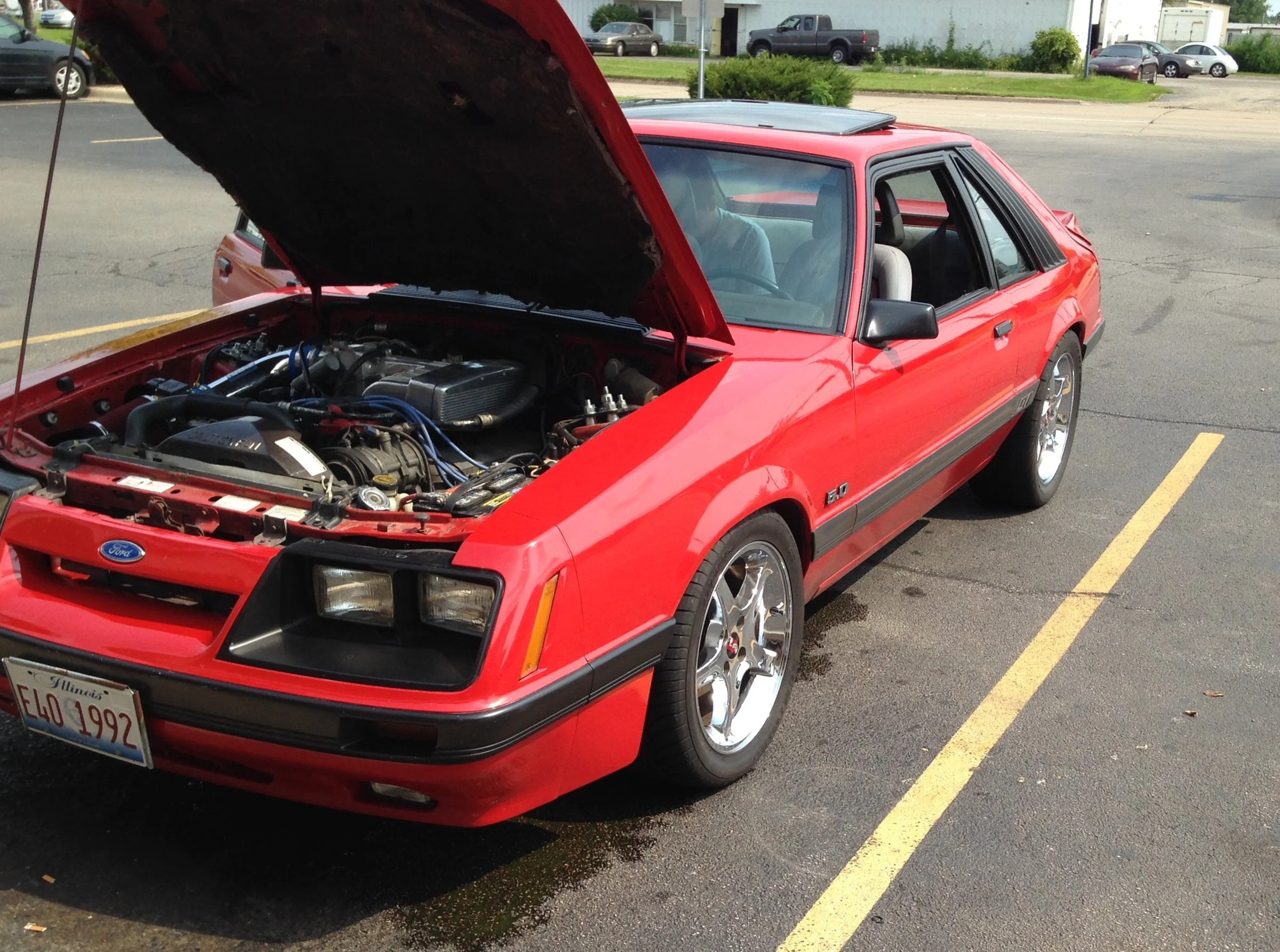

I run regular eibach lowering pro kit springs up front . Both away bars still in and hooked up . I run team Z drag springs out back . Strange 10 way shocks and struts . My best to date is 1.55 60ft weighing 3480 .
While not outrageously fast it deff is starting to come around . It did pull the 17inch standard front wheel a hair . It does sit pretty aggressive too in my opinion .

Thanks man the car still rides decent for what it is . I should've said 3480 with me in it .

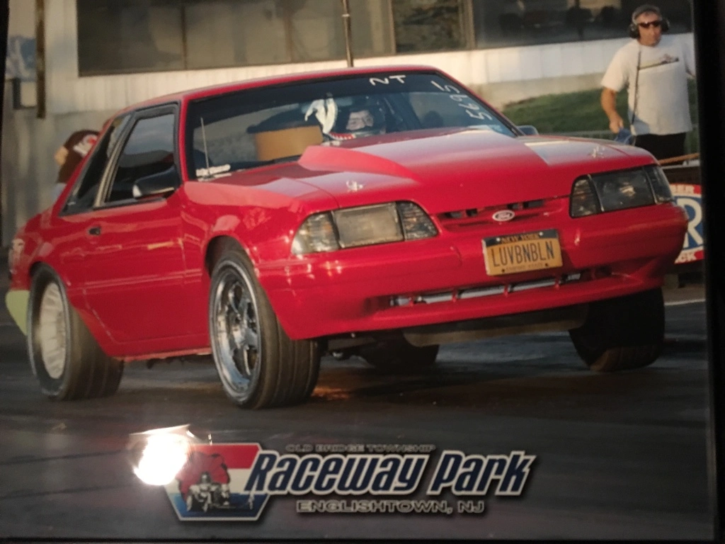

Dart block , stroker , blown . 5 speed car that I drive everywhere . Makes 581 to the tire on 13psi with an anemic blower .
That pass was on an 80 degree day in not the greatest air - drove to the track , lowered air pressure adjusted shocks and went 1.55 60' , 100 mph to 1/8 , 10.86 at 128 with the clutch slipping when I shifted 3rd .
