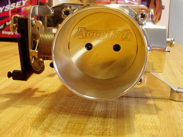

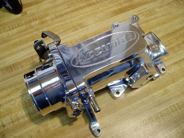

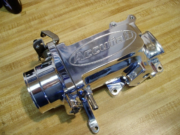

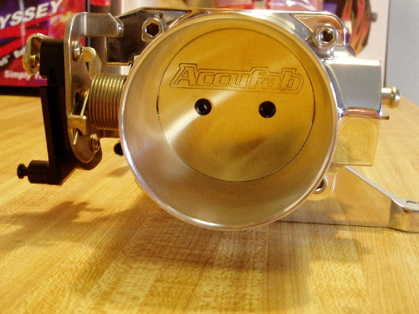

02LaserRed2V said:
Accufab Plenum AND TB
Accufab has my vote
http://www.stangfreak.com/
