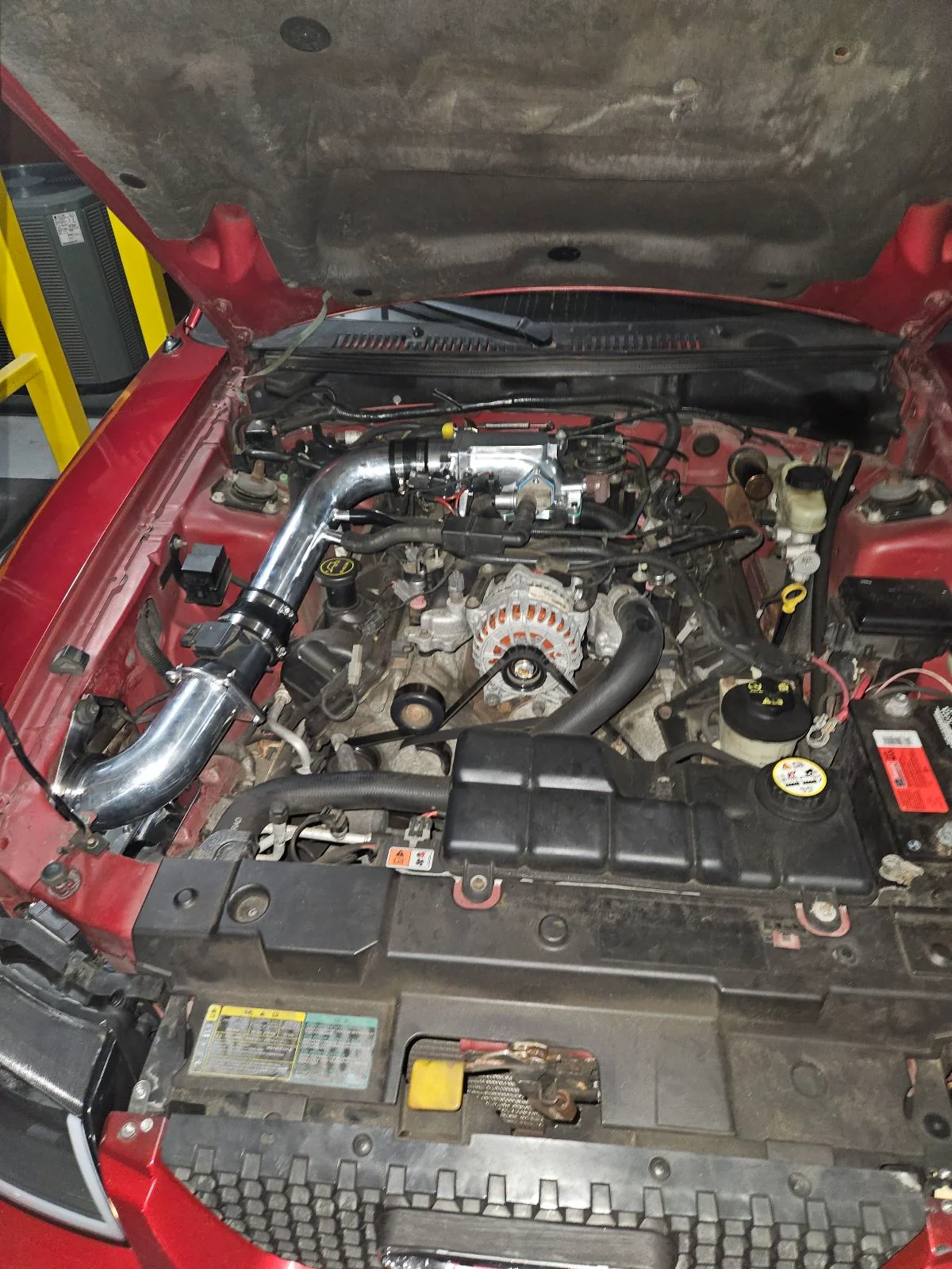

Gotcha. Just good to know where to start troubleshooting...odd that it was driving fine before that. Can you post a pic of your engine/throttle body setup?
PLEASE DISREGARD THE DETACH MAF SENSOR, the pic was taken prior to attaching it.
