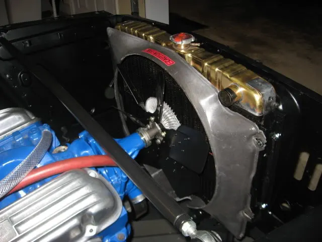

I have a '67 with 289 and the 20" originally. I wanted something stock looking, the only alum. ones I found that didn't look like boxes on top were Griffin and $$$. I went with the '68 302 AC 24" radiator from NPD. It's a 3+ row, not sure what the + is as I can see 3 rows in the cap.
You can either use the '68 upper/lower saddle mounts or make your own side mounts as I did. I went with a solid fan/ thermostatic clutch and shroud. I don't think I'll have any cooling issues.
I had to strip the upper tank for a repaint and liked the raw brass look so much I decided I'll keep it for a while. I still need to paint the straps that come up the side black and give a a spray of clear coat but i like it:
