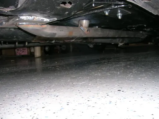

Yea, I paid $225 labor for mine.
Total cost
$120 + Shipping
$10 Sherwin Williams Rust Inhibitor spray paint
$225 Labor Installed
$355 Total, but worth it.:nice:
