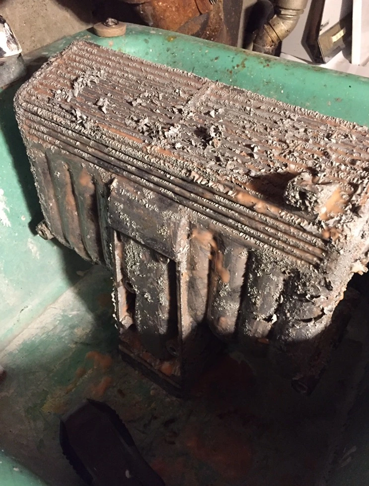

If you determine the intake is too far gone and just want to strip the paint off completely.....Citristrip will work. It's not a degreaser, but a safe paint stripper. So a little bit more work this way.
But if you smear it on and let it sit a day or two, it will do this to the intake. Then just powerwash and scrub it off, and repeat if needed.
Then, a good degreasing of the bare casting, and some primer and paint and good as new. I also took the time to sand down some of the casting flask with a sanding disk, as well as cut off the vacuum tree nub on the plenum edge.

Outstanding work on the intake; looks great. I just got the citrus-based cleaner in the mail yesterday so I'll be giving it a try to clean up the sludge. After that I may go ahead and try the Citristrip as well. It seems to really work well.
