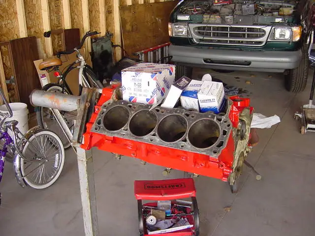

POR-15 makes a really good engine paint. I bought their engine paint kit which comes with metal prep, degreaser, cleaner, paint, etc for around $35 or so. It really holds up too. I used Ford classic red. Here is a pic...
