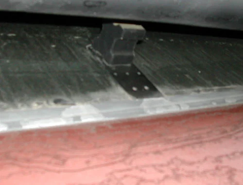

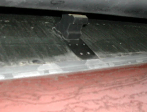

i have heard that some1 makes a support for the bi-wing on the svo's and was wondering who it is and how do i get 1? im sure some1 here knows something about it, so if u have any info please let me know... thanks!
the only problem i see with this (and it just might have to be this way) is you have to drill holes in both the deck lid and the wing right? are there ne to where i dont have to do this?
You could use double sided tape as well....

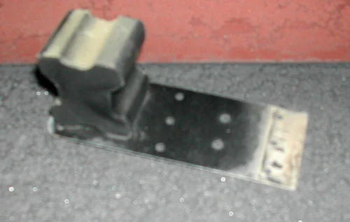

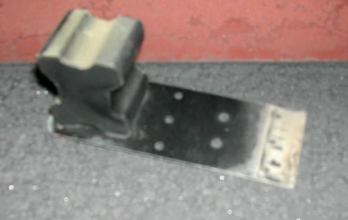

I just went to the hardware store and got a small piece of flat aluminized steel, painted it black (blends in with the glass), put a small piece of rubber on it that is made for going inside coil springs to raise the ride height...it is held in place by the window channel moulding and fits tight under the wing so it can't move...
You guys lucked out, it warmed up to 19 degrees (note the frost on the car).
