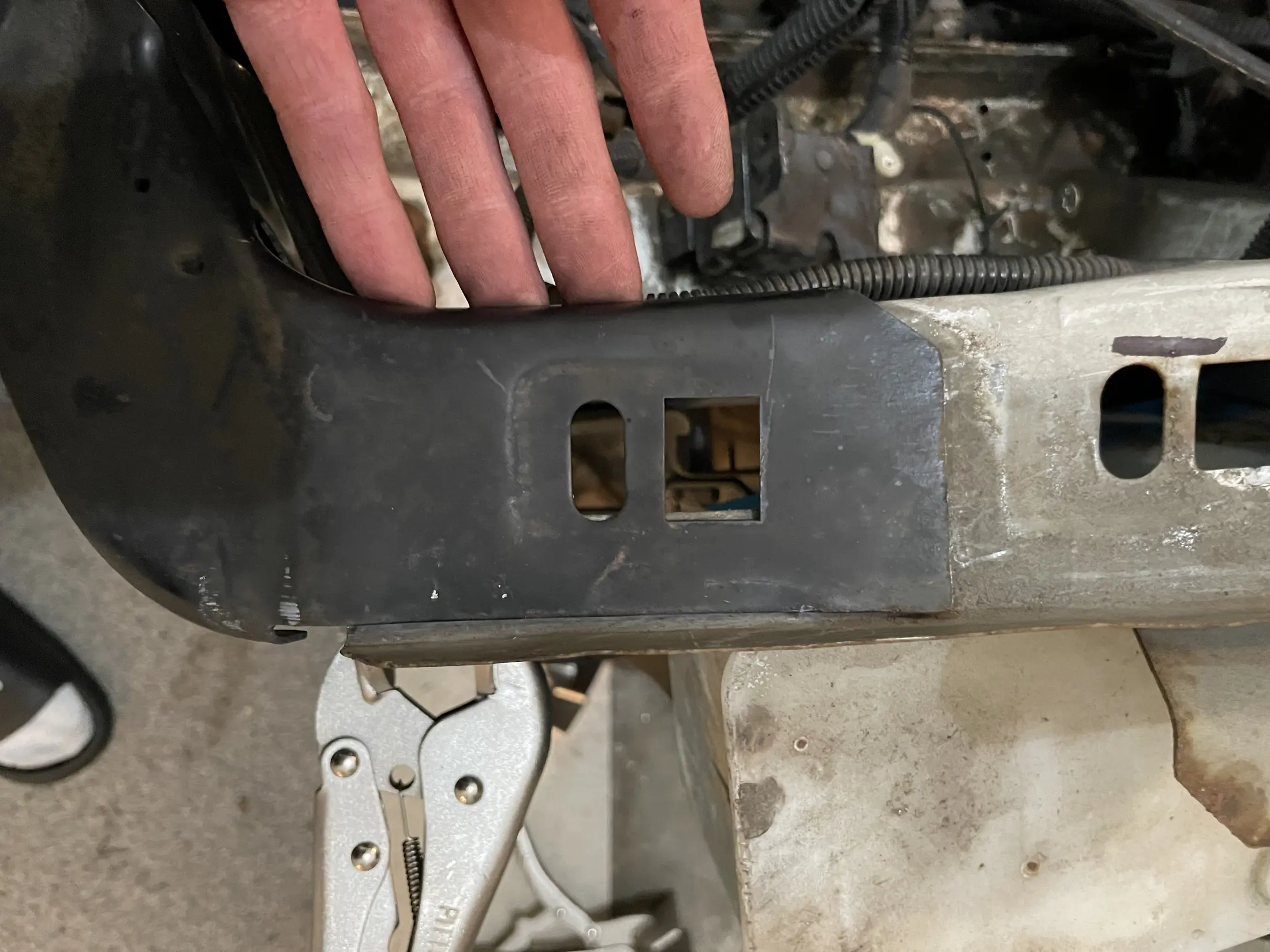

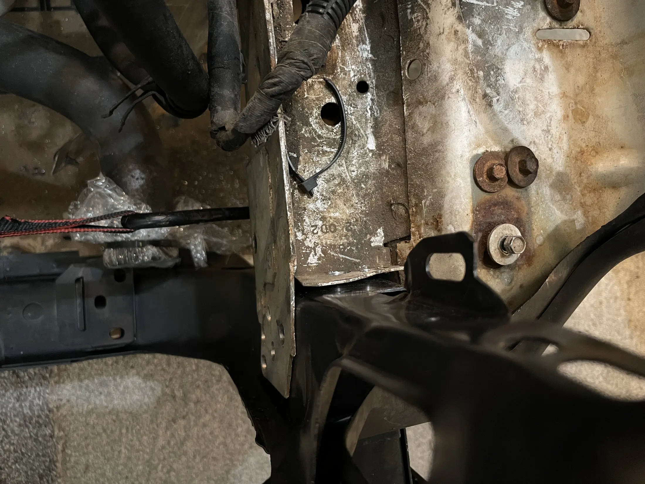

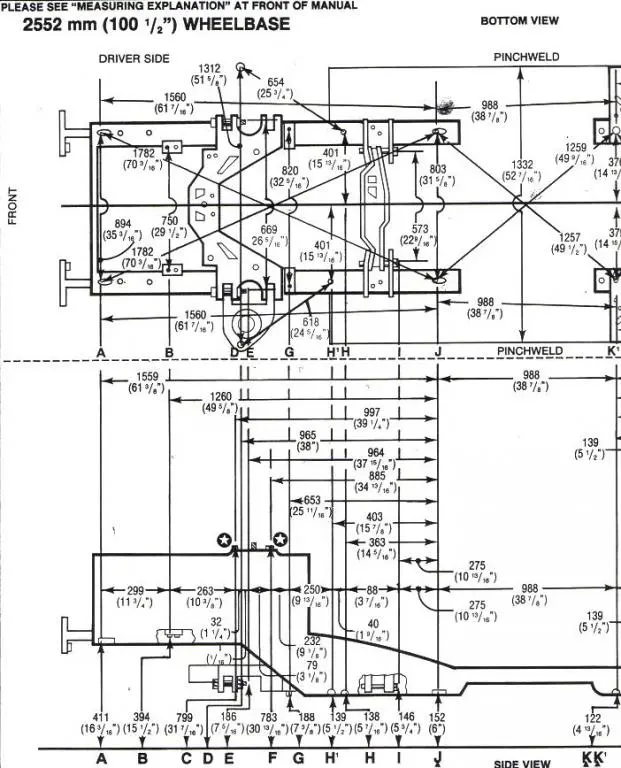

I'm currently in the process of repairing some relatively minor crash damage on my 1993 LX and I am replacing the front core support. I have a replacement core support from LMR but it doesn't fit properly. The frame rails are maybe about half an inch too far apart for the core support to be installed easily.
I'm wondering if maybe my rails spread apart slightly and I'm hoping someone has some dimensions I can use to check whether or not my car is messed up or if the core support I got is defective. Also some advice on how to fix this kind of thing would be greatly appreciated too.
I did cut the old core support in half to make it easier to remove from the car and it didn't spring apart or anything so I'm not really sure whats going on.
Attached is a pic of the crash damage. Doesn't seem like it could tweak the frame rail but I know these cars are notoriously fragile.

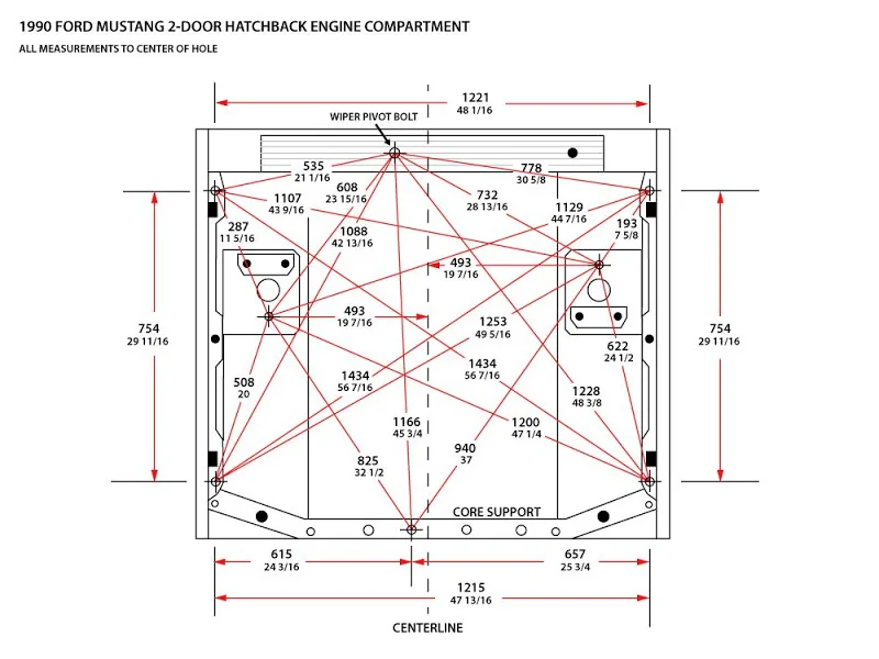

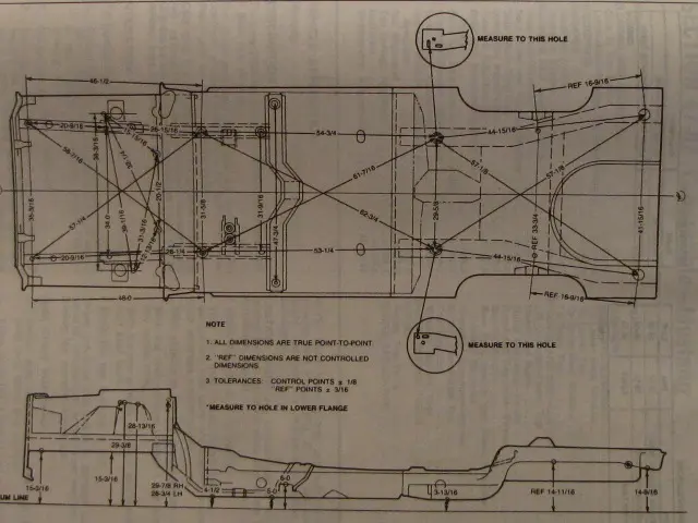

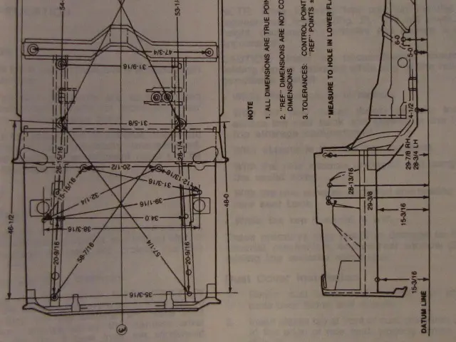

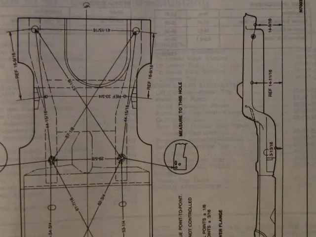

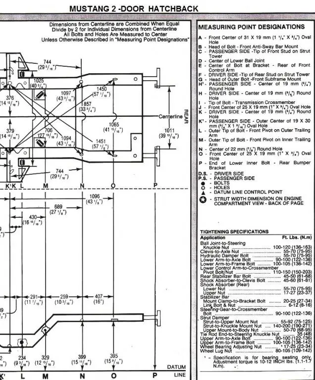

I don't know if they would apply directly to your '93, but should get you in the ballpark of square. Not sure where they came from but I downloaded them from the internet over the years.

Based on the dimensions shown above, where and by how much are you out?
You wouldn't really be able to tell anything from a picture since it looks completely fine visually. The rails are a half inch too wide where it is supposed to mate up to the core support and so it won't slide into place without forcing it in. I could definitely install it with brute force but it's not really ideal.

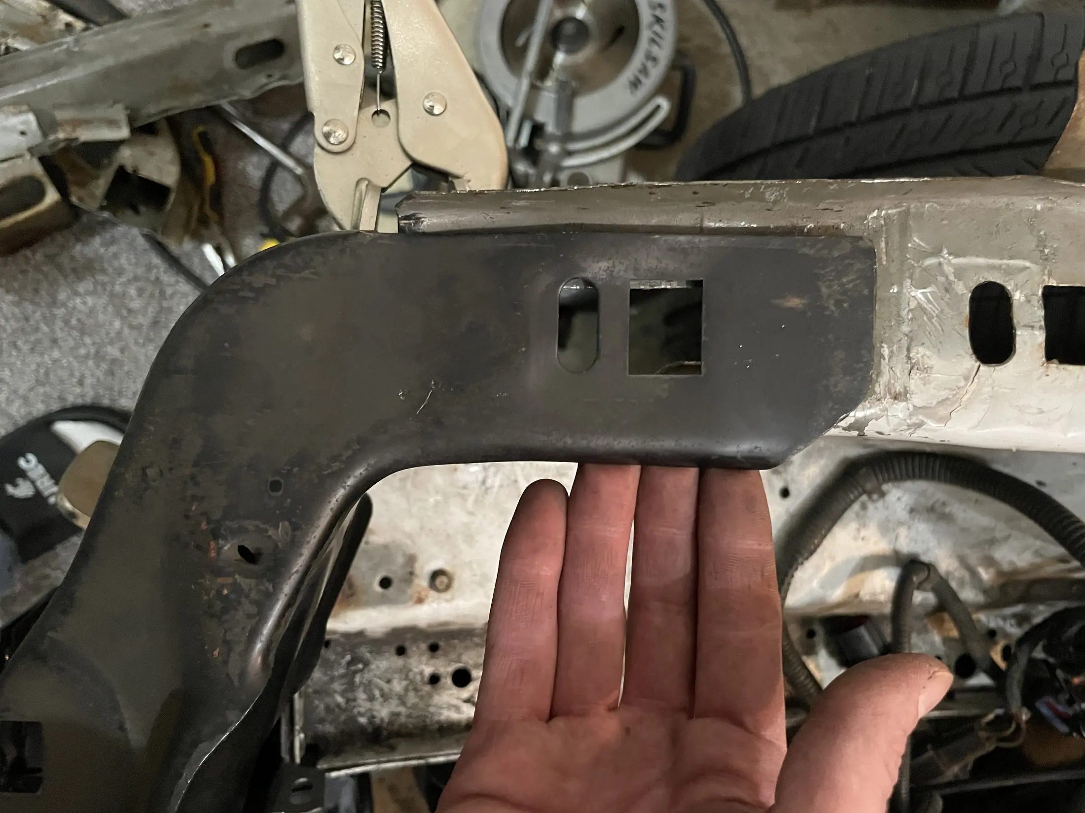

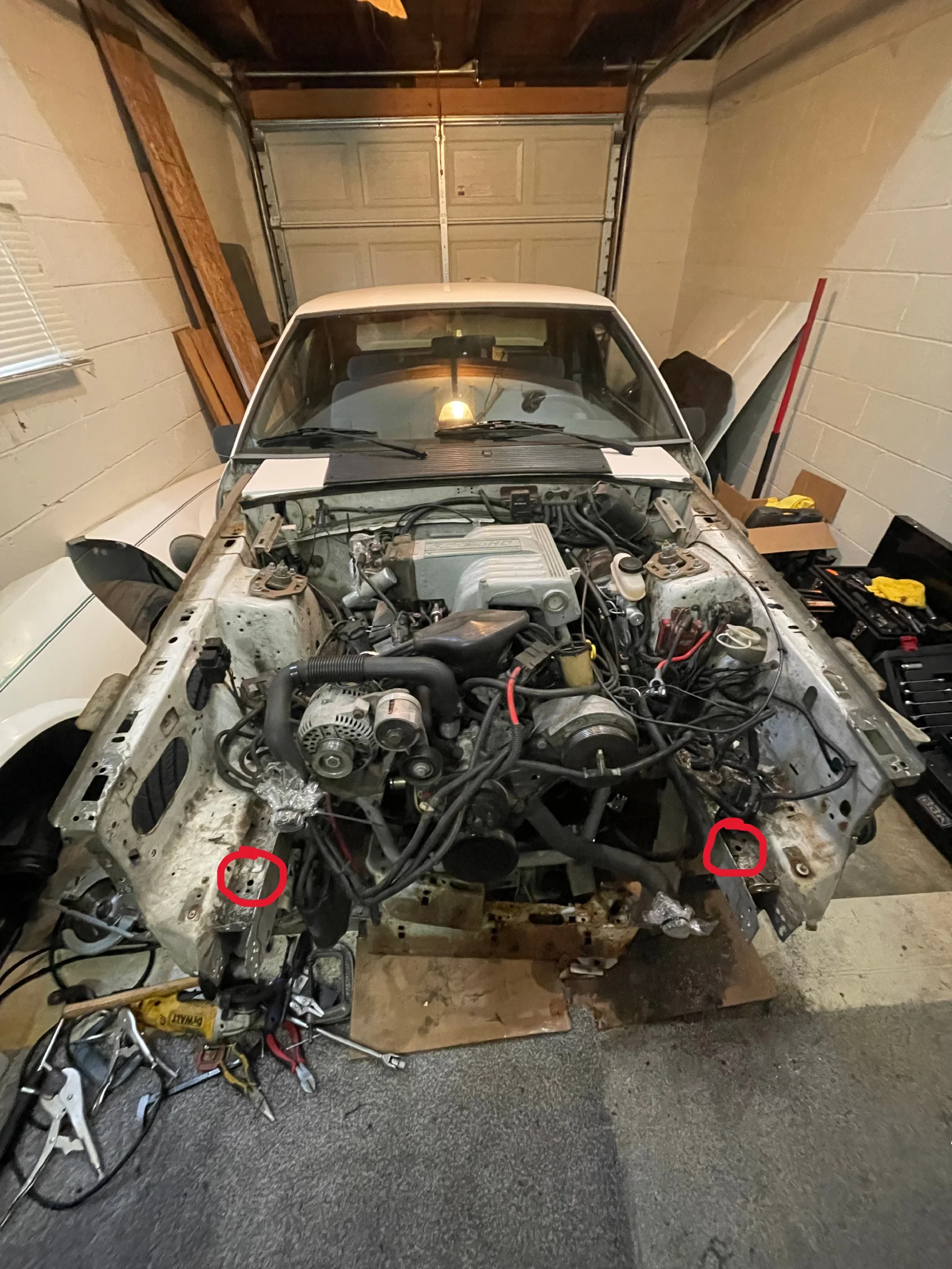

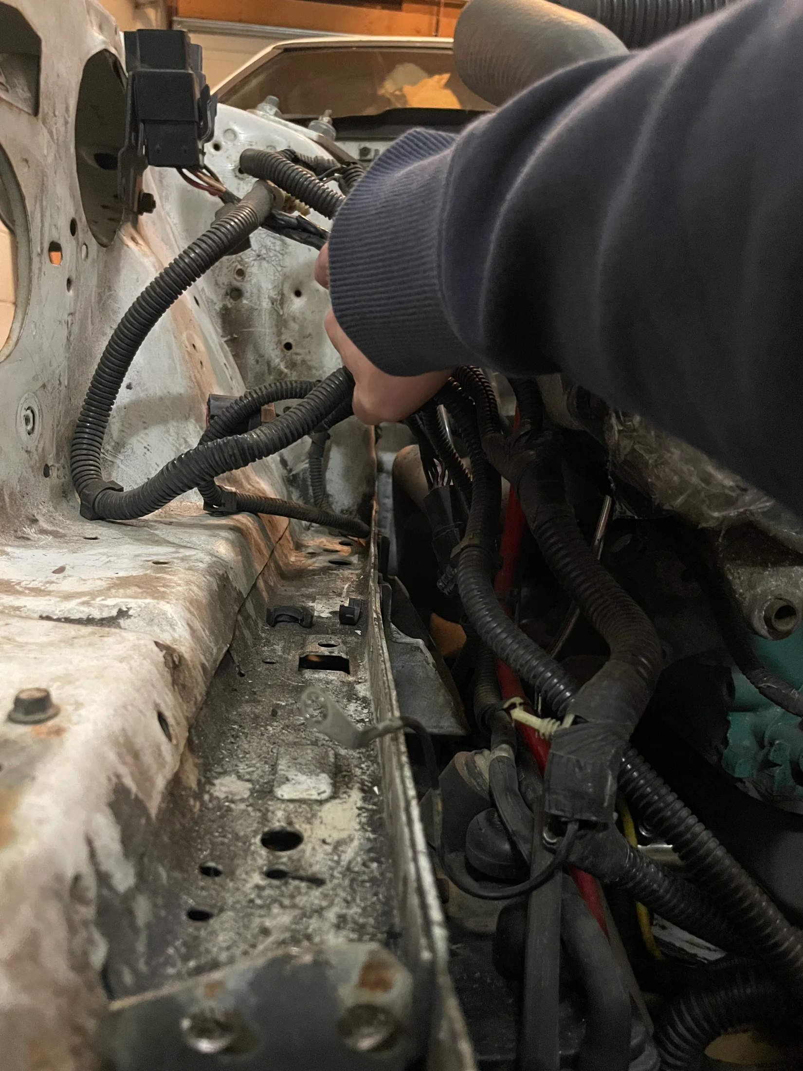

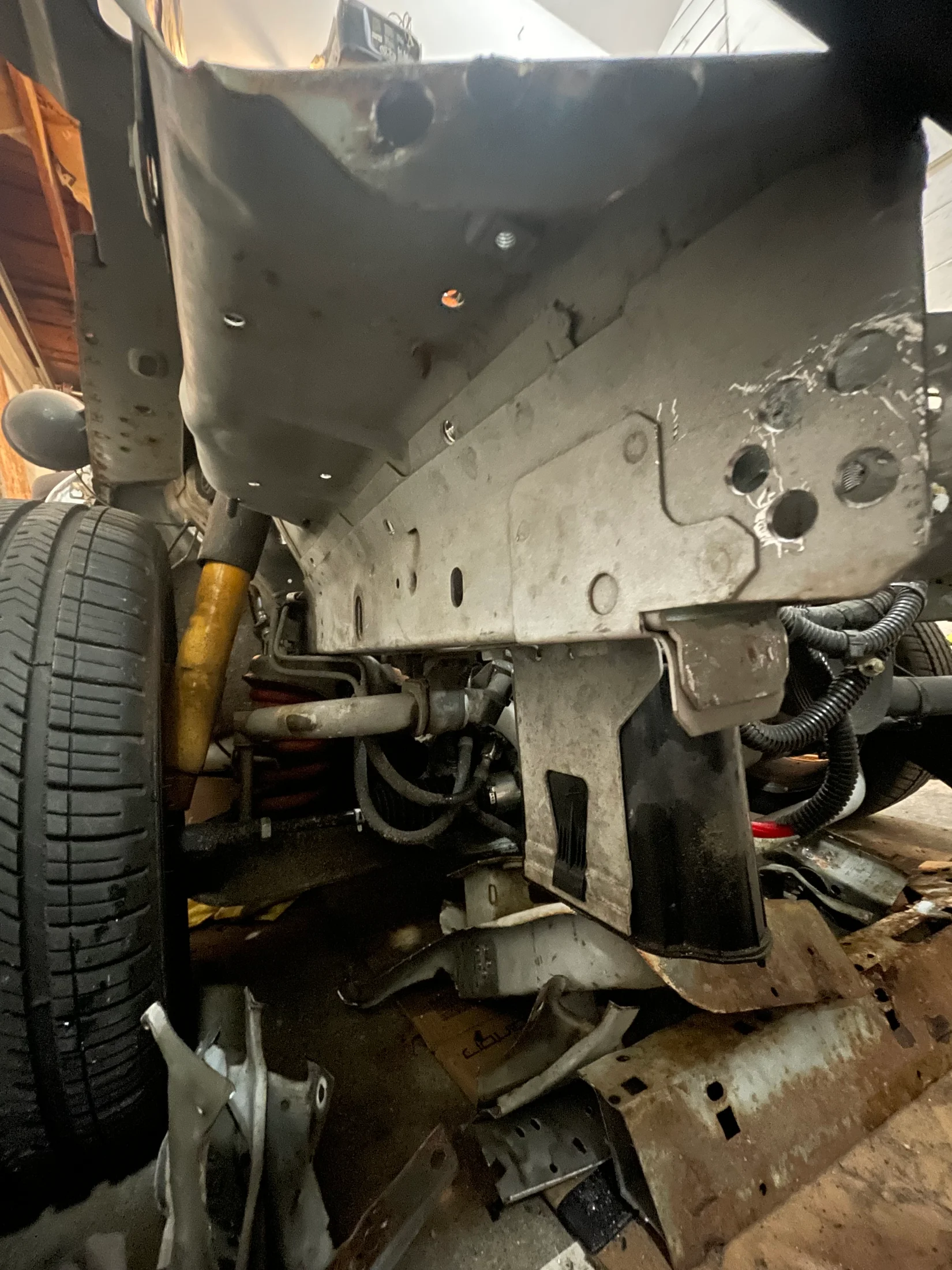

Okay got some pics. I measured between the tooling holes that I circled in red and I got 35.25" which I think is actually in spec unless I am misunderstanding the diagram that was posted by @KRUISR. Also did not notice any kinks or bends in the rail. What do you guys think?
I believe that dimension is correct. What are your measurement when you measure at the top area, triangulate to the strut mount bolts?

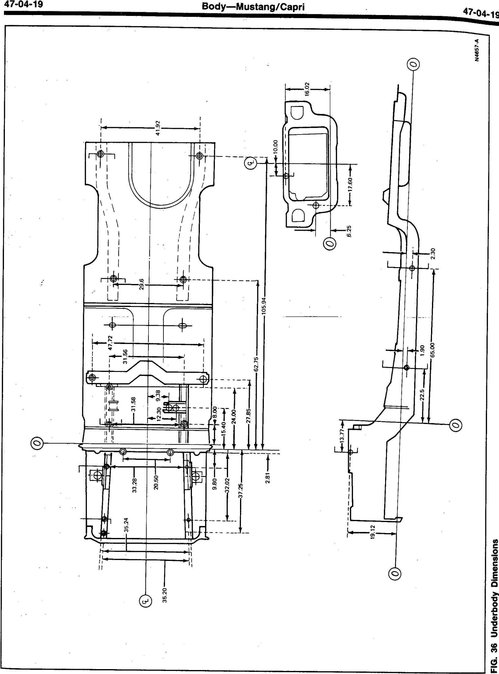

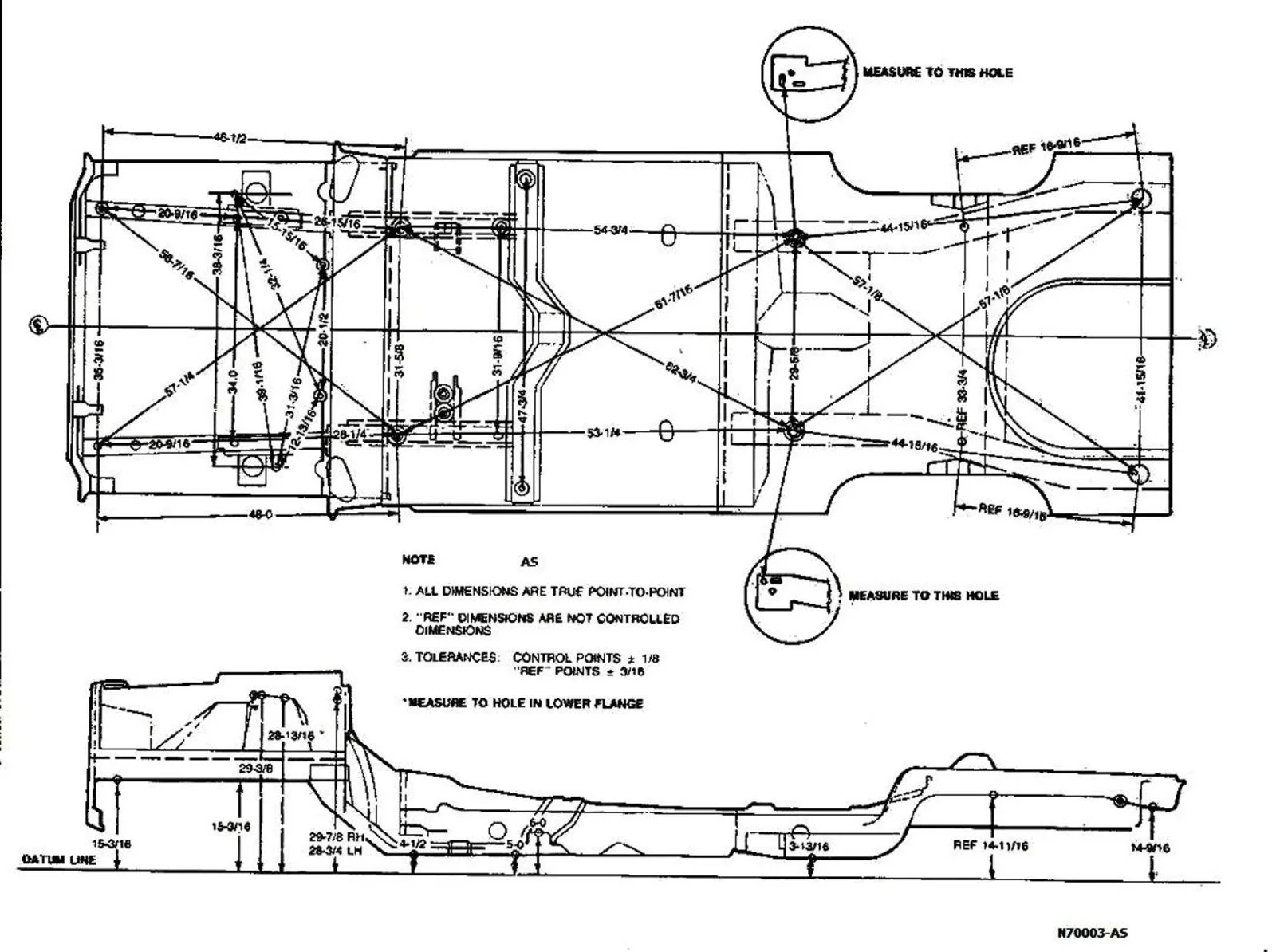

I found another frame drawing...
Not sure if the holes referenced in this drawing are on the top or bottom of the frame rail (I don't have access to a foxbody right now to check - or measure), but the 35-3/16" is smaller than what you measured. I would guess on the bottom as it would be easier to check some of the measurements going back to k-member mounts or trans mount area.
From the drawing that has measurements along the top, try and find to front holes on each side (I would use the reference measurements from a hole at rear of engine bay and/or strut top plate bolt holes) and check for that 47-13/16" across the front. Its possible the top has bowed out as well.

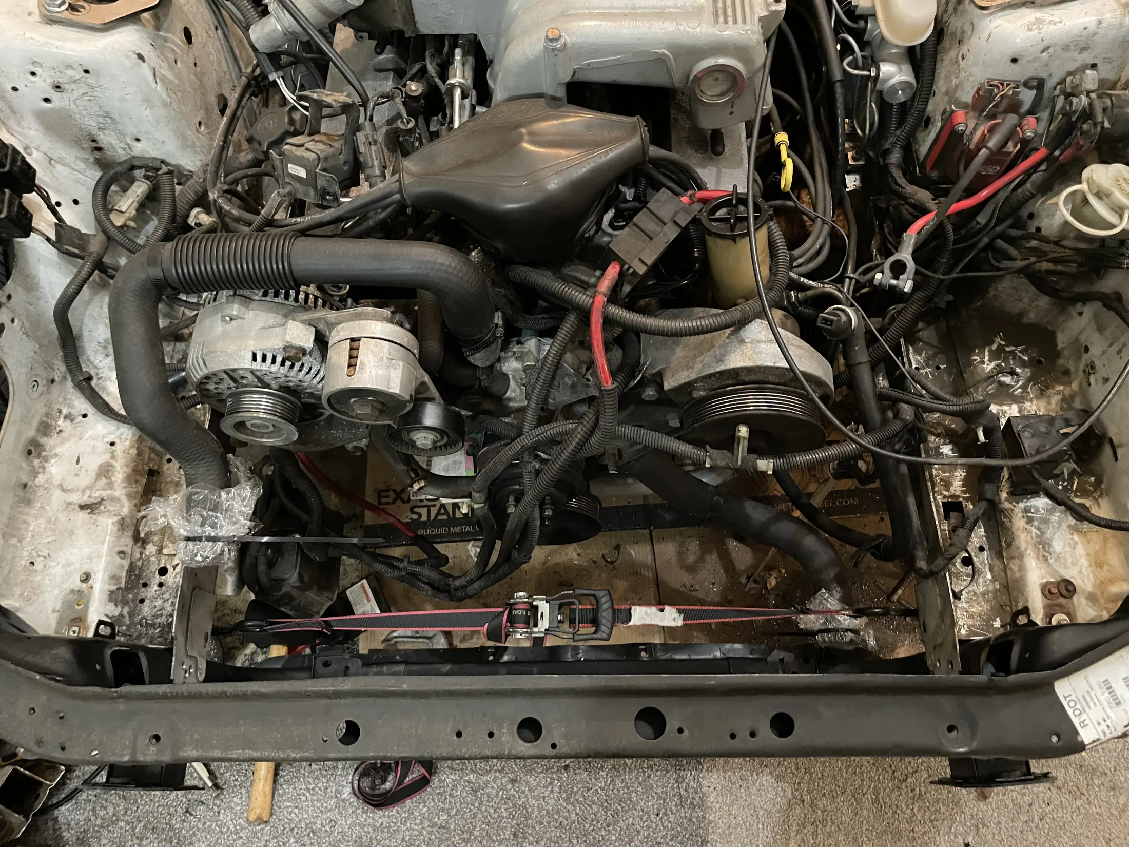

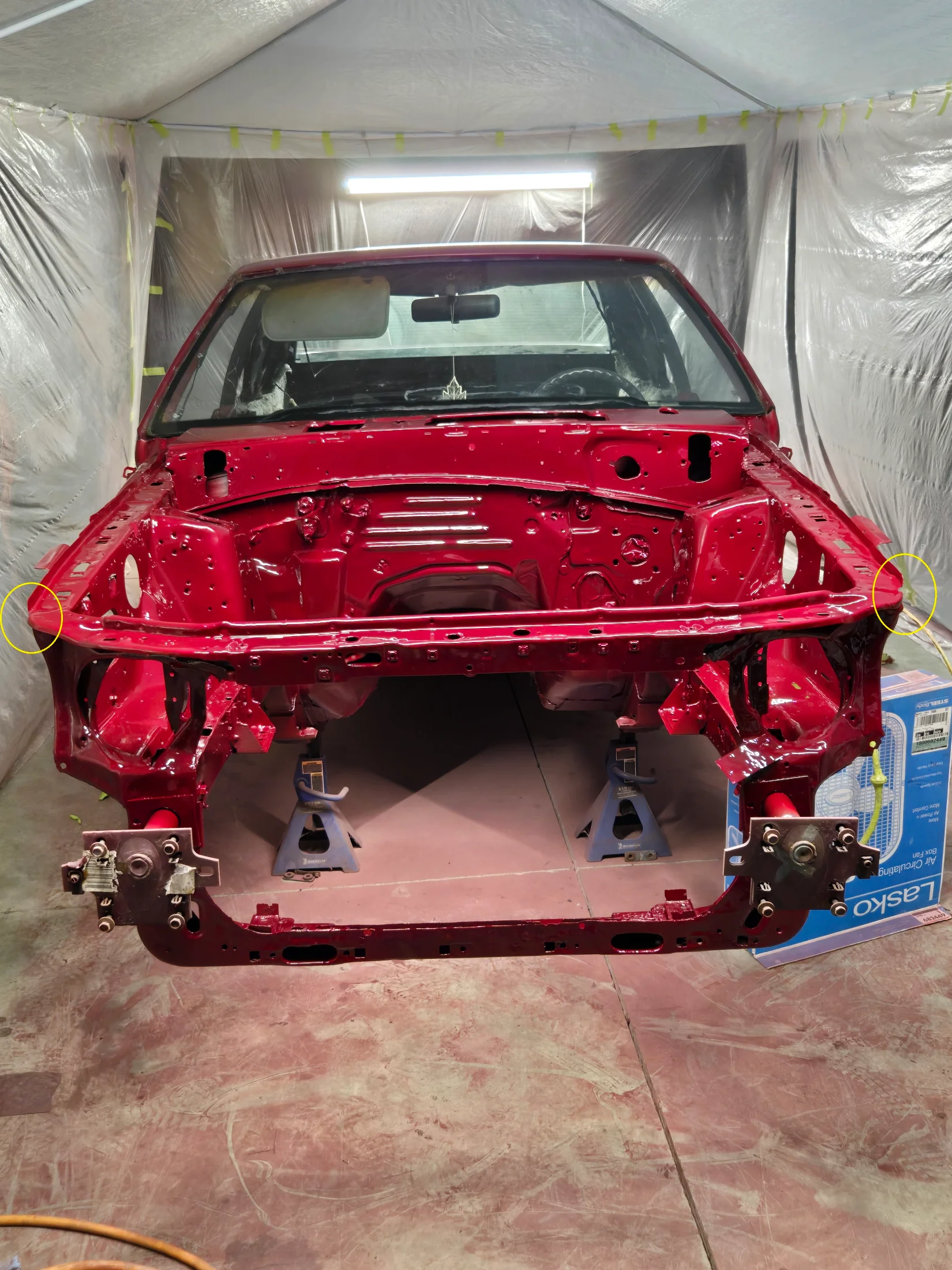

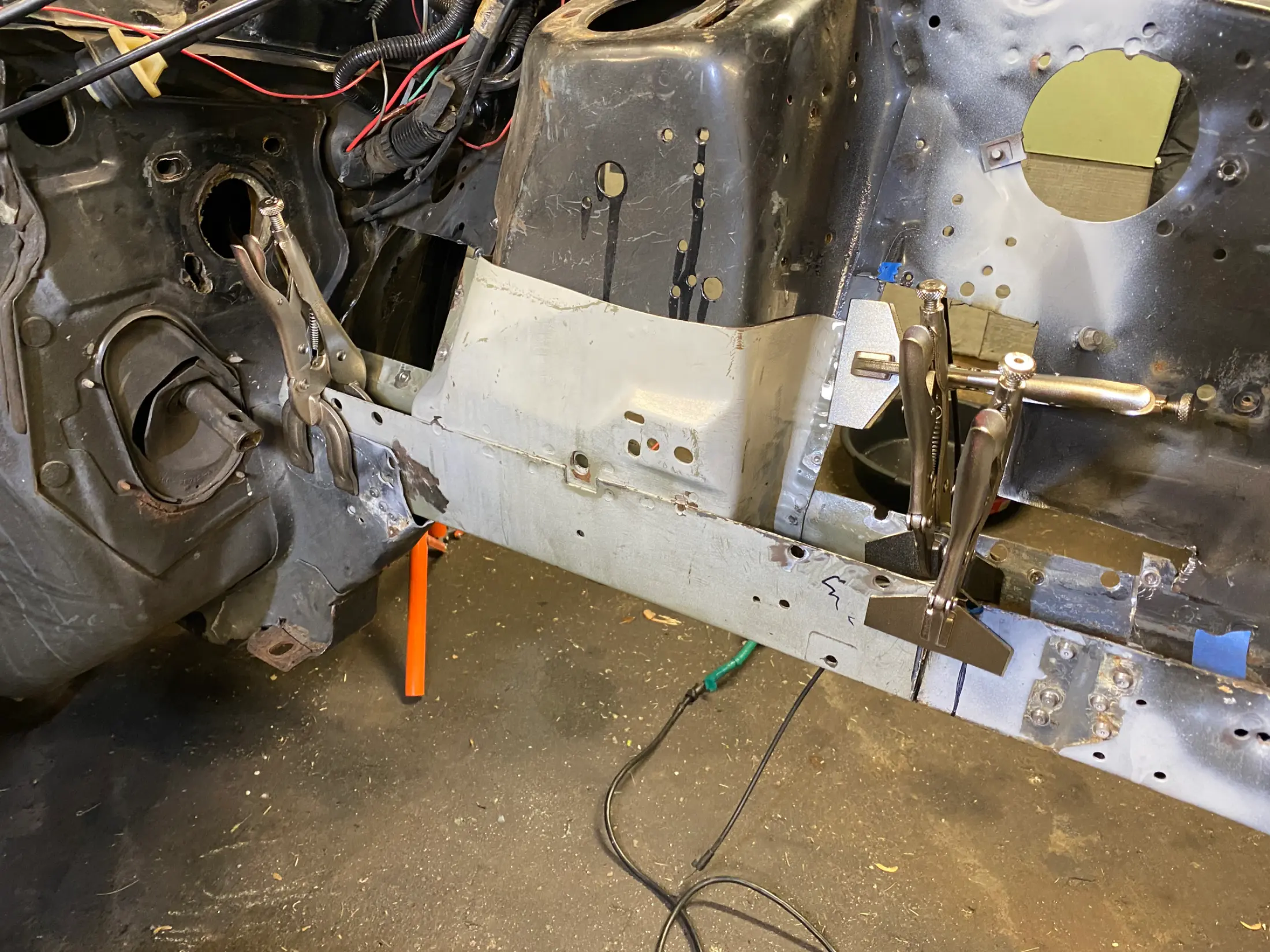

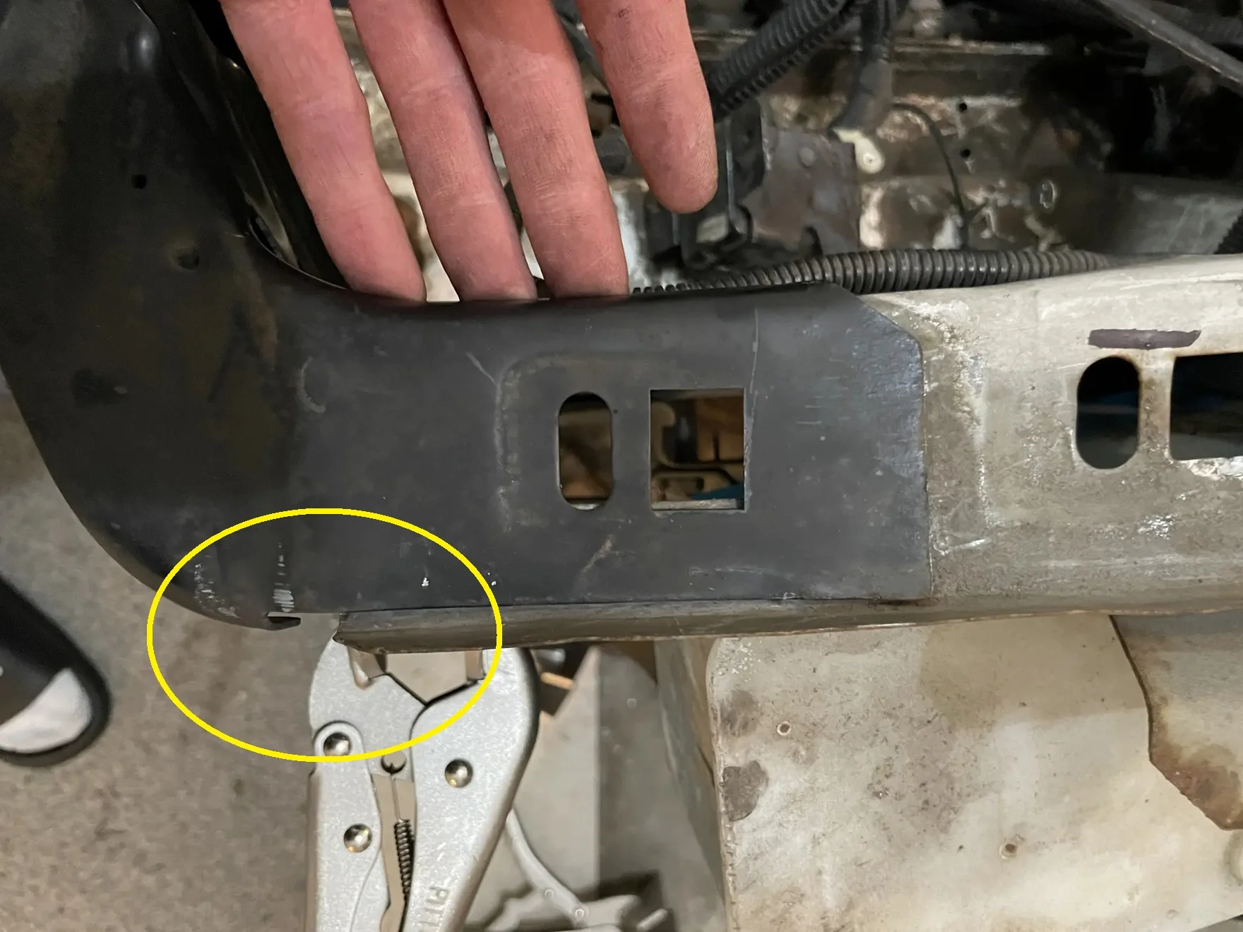

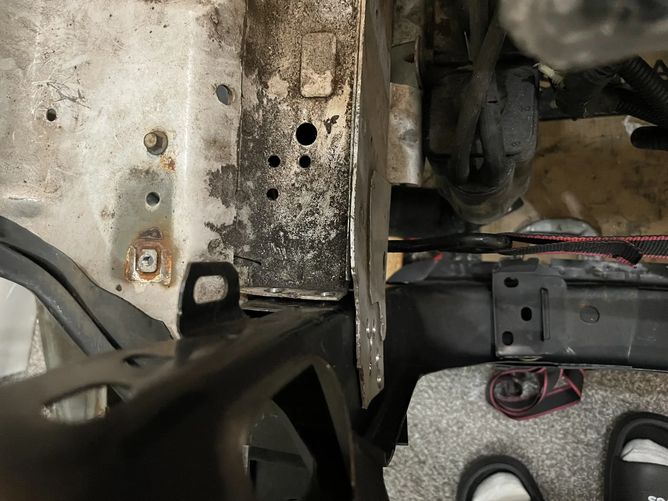

Alright it took me a little longer to make progress than I was planning but here is the update. I wasn't really able to measure much because the engine is in the way and what I was able to measure wasn't out of spec enough for me to draw any clear conclusions since I was using a tape measure and I'm sure the tolerances when they were assembling these things weren't exactly aerospace levels of precision.
Here is the solution I came up with to get the core support to fit properly:
I used a ratchet strap to pull the rails inward and it ain't pretty but I only needed to move the frame rails about a quarter inch closer together to get this to work. It should be good enough to achieve the results I'm looking for. Other than that everything fit pretty well.
The areas where the core support meets the top of the inner fender apron are a little uneven but not too bad. What do you guys think? Is there anything I can do relatively easily to get it to line up a little better? I have good contact on all the surfaces that need to be welded except there is a small gap where the frame rail butts up against the core support that is visible in the pictures.
The dimension of these gaps on each side of the core support on my son's '89 GT were not the same from the factory. I would assume that could still be the case with the '93s. I will take a couple of pics later today and include them here. If you need any other dimensions measured I have access to the car this until the weekend.
