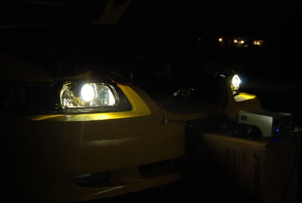

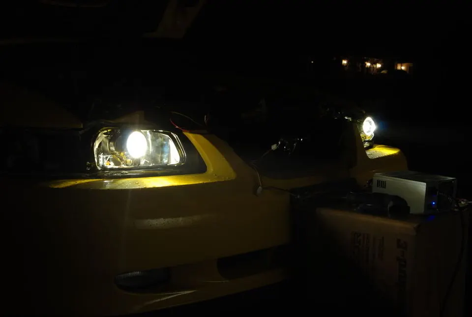

I used to have a plug and play hid kit and didn't like how they looked. So now im spending $650 and getting a full hid retrofit into the stock headlights, the company doing the install are using infiniti fx projectors, i'll have low and hi operation and everything is gonna look amazing. I just have to wait till march 10th because he has a long wait.
Who is doing the work?
$650 isn't bad. I've seen some guys do retrofits and pay upwards of $800. They look awesome too because the lights look stock, but the light output is amazing and done "correctly"
the place is www.retro-solutions.com, they said its gonna be the first time doing the 99-04 mustang headlights but they've done a bunch of 05-up already. He knows how the headlights look and he said its gonna look perfect when its all done. Everything is included, fx projectors, ballasts, custom harness, 4300k bulbs and he's painting the inside of the headlight black. Im pretty sure im gonna be one of the only people with a real hid retrofit in our headlights, could be wrong though. I've seen the work he did with my friends rsx and you would think his car came stock with them, its flawless. If anyone else is gonna get it done mention my name, maybe he'll give me a discount or something, its randy.
http://www.hidplanet.com/forums/viewtopic.php?t=36224&highlight=mach
Seen an 03 Cobra about a year back on there as well. Not the first, but one of the first :nice:
Did you include the headlamps, or did he include that as well? If the latter, it's a steal!
