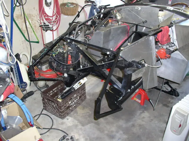

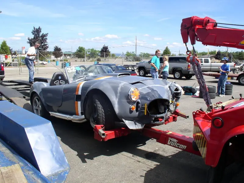

Most of you will remember my wreck at Watkins Glen in August, where I completely fubar'ed turn 9, and hit the Armco quite hard...
Once home, with the body off, the real extent of the damage was assessed...

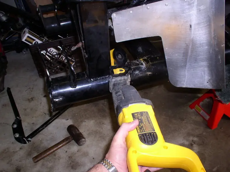

Basically, EVERY piece of front suspension on the driver's side was ruined, even the spindle and rotor. The frame was checked, and only the LCA mounts were trashed, and the motor mounts bent forwards 3".

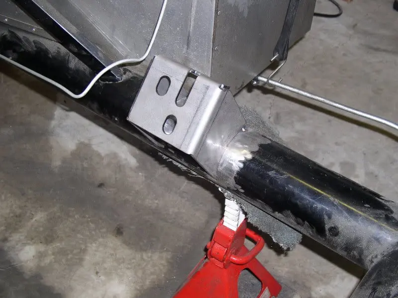

The bad mounts were cut off the frame...

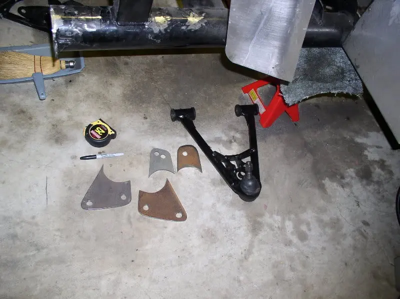

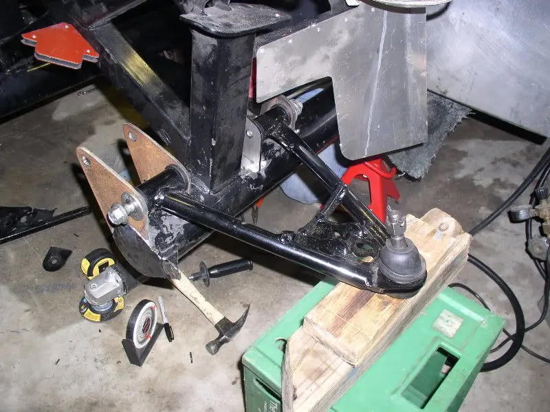

And new frame parts were both gotten from FFR and made by Cobranetto (Ben Carbonetto), since my car is a MKII, and FFR only had MKIII chassis parts.
The chassis was thoroughly checked for square and straightness, and was determined to be OK.
Lots of measuring and checking was done as the new parts were slowly tack welded in...

Once it all was done, Limey69 (Chris Walls) came over with his welder, and welded everything up.
Some paint to match the powerdercoating...

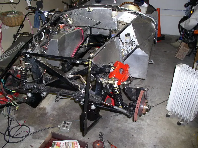

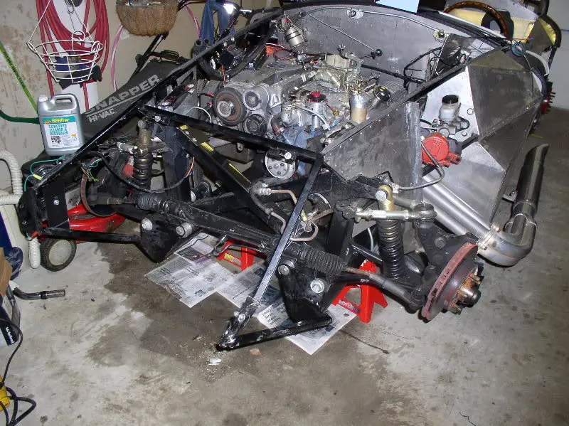

And new parts installed...
And hopefully the car will be back on the road soon! Next to finish the suspension, sleeve the rear of the crank, get the motor back in and go-Kart!
