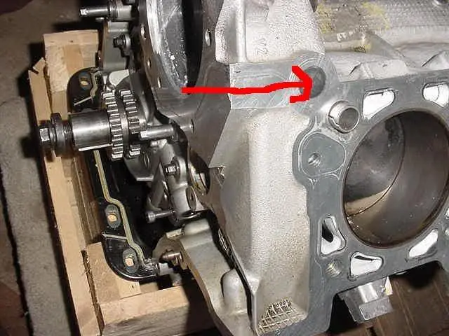

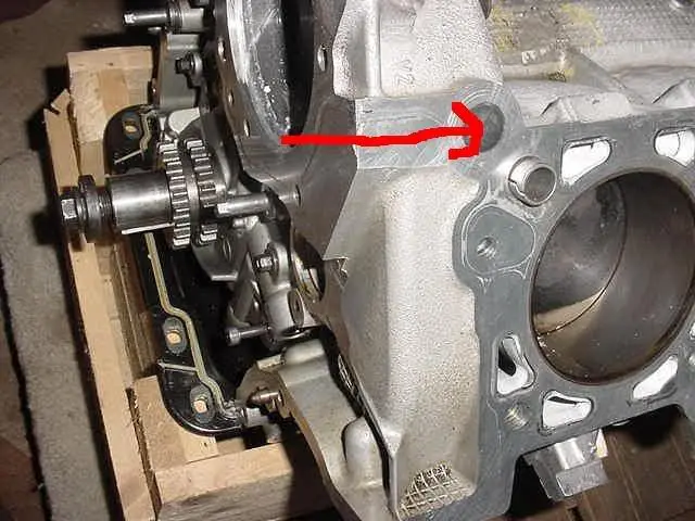

Hey, Bob. Randy was telling me in a nother thread that in order to use 2-valve heads on a Cobra block I would have to use a 2-valve timing cover and drill the holes in the block for it. I was told before that I would need a 4-valve timing cover. Did you use a 2-valve timing cover? He also told me that all of the timing parts would swap over from my GT block, except for the swing arm chain guides. What did you do for the timing chain guides and sprockets? I certainly wouldn't doubt Randy, I was just wondering...
I am using a 2V timing cover from a 94-95 4.6 Tbird/Cougar...its a direct swap. You can use your stock one but one of the bolt holes doesn't line up so it needs to be sealed with RTV. I wanted to do it right so i found the correct cover over on TCCOA. I have the part # saved in a pm on another forum, i'll look it up and post it for you...and Randy is correct about the different dowel pins in the Cobra block. I bought all that little stuff from him.
You also have to drill a hole where the water pump is on the block...i have a pic i'll dig that up too.
F3AE is the timing cover you want...
and drill here

Bob -> If I go with this F3AE 94-95 T-Bird cover I won't have to drill any holes - its as if it was made for a Cobra block with 2-valve heads? And I should drill that hole out because the 2-valve (NPI and/or PI) heads utilize it for the coolant?
