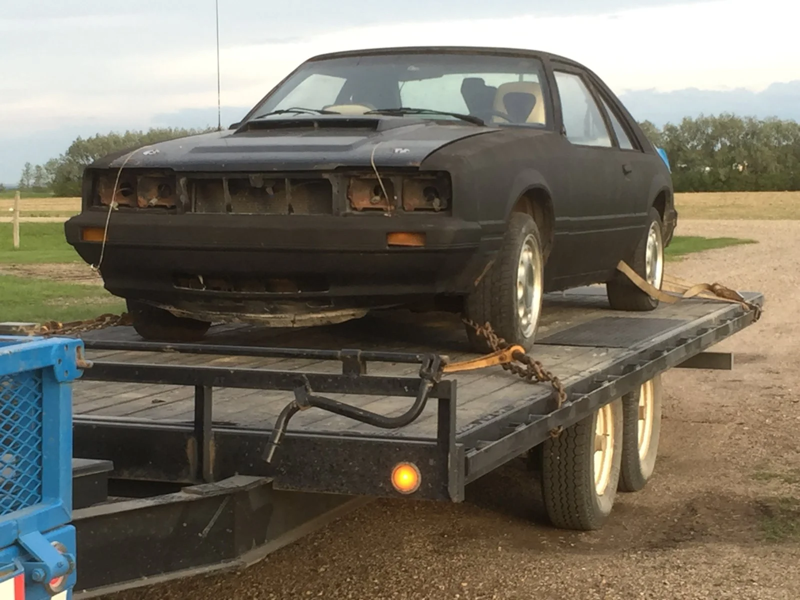

It all started when my neighbour and best buddy bought himself an 86 Notch. As I was hunting the classifieds for fox body parts for him, I came across an ad for a 1983 Hatchback for sale or for trade. Just for the heck of it I offered to trade one of my race quads straight across for the car. The guy jumped all over it and off I went to have a look.
This was no show car, that’s for sure! And although the quad was worth more than he was asking for the car, I had only paid $800 for the quad so all I needed to see was potential in the car. After inspecting the underside for major rust issues and finding everything in surprisingly very good order, I did a quick vin search which turned up a squeaky clean title. This is when I saw that the car was actually a 1980. When I asked about the year, he proceeded to tell me that the car was originally a 1980 Cobra, but he had been attempting to fix it up using 83 Mustang and 83 Capri parts cars. Not knowing much about these cars, we made the deal and I hauled the car home.

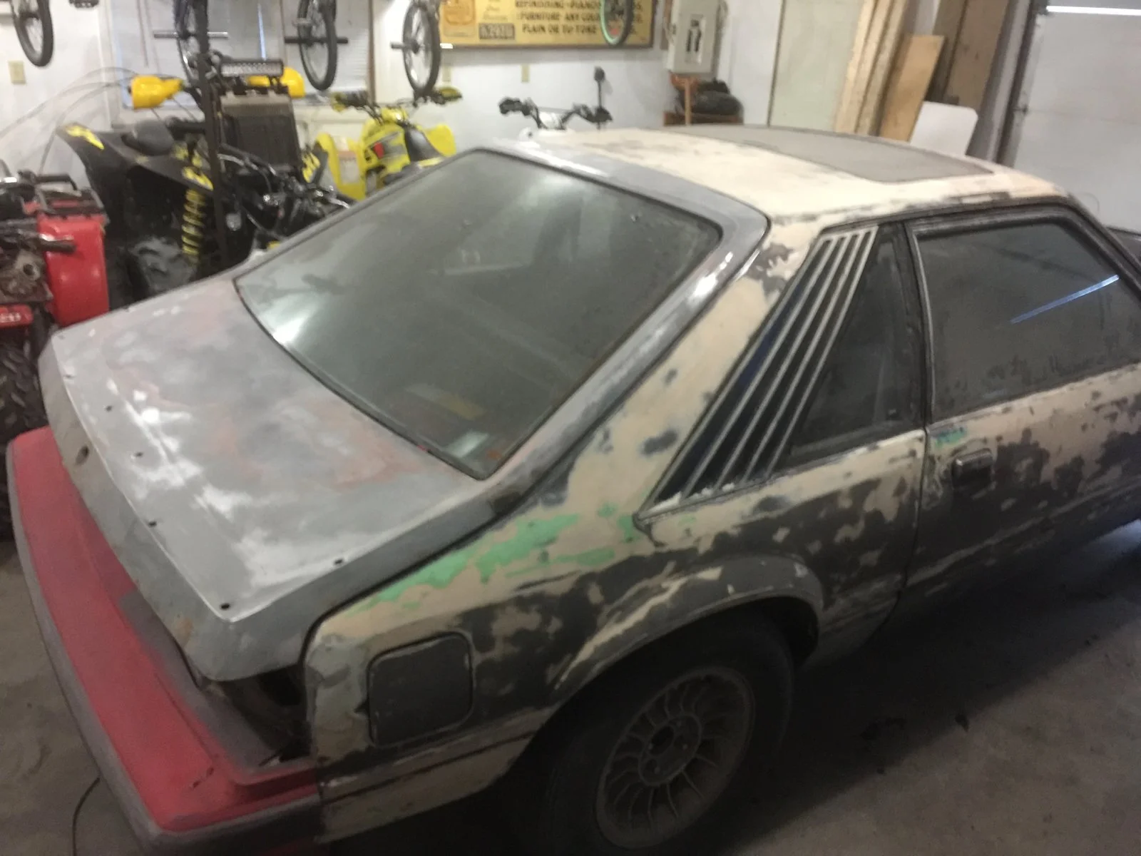

The previous owners figured it would be a good idea to paint the entire exterior of the car with high solids rubberized undercoating spray paint. Let me tell you, this is not even a remotely good idea and if you ever try painting a vehicle with this stuff, better hope you never run into the guy you sell the car to... as he will not like you very much at all! A couple spray bottles of goo/adhesive remover (even really good paint stripper doesn’t work very well for some reason)let it soak for an hour, then spent an entire day using a plastic scraper which yielded a couple gallons of what can only be described as a black tar-like substance that never dries.
After seeing what the car looked like underneath and searching the salvage yards for parts to swap out the hideous Capri rear bumper cover and strange looking sunken taillights, I figured I’d do some light body work and at least make the car one solid color. A nice little added bonus I discovered while piecing together and cleaning up the interior, was when I removed the seat covers to find Recaro seats. Had no idea what they were until I hit up a google search, but they sure did look like they’d be a cool looking seat once they’re recovered. Really dig that mesh headrest!

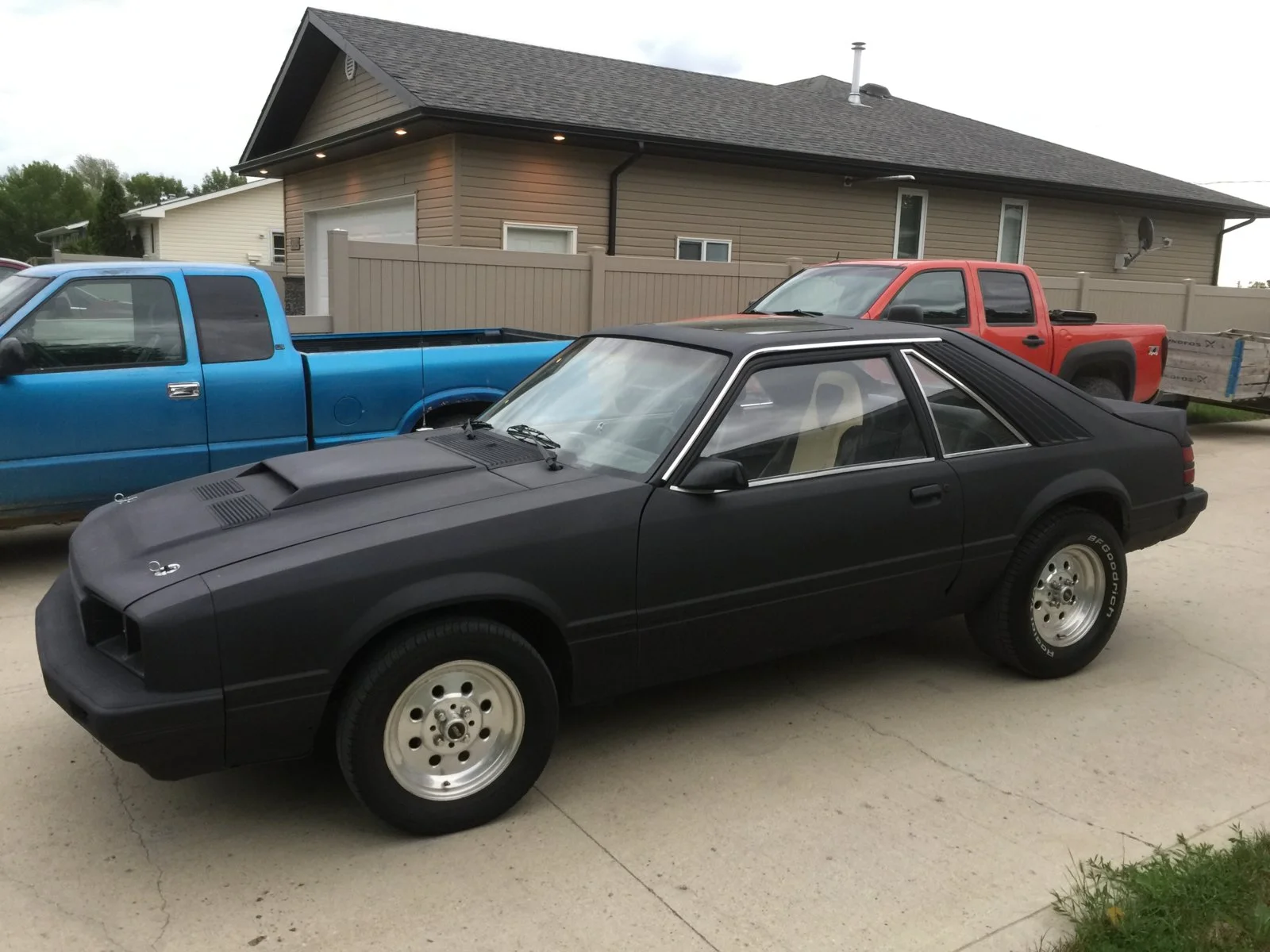

It came quite a long way in the first few weeks, as I’m a pretty motivated (and impatient) individual when I want to get something done. Here she is so far...

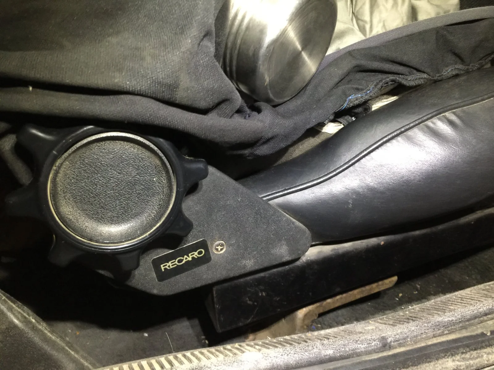

Trim number the W is not listed, this may be due to it being equipped with recaros, the second digit (A) is black interiour

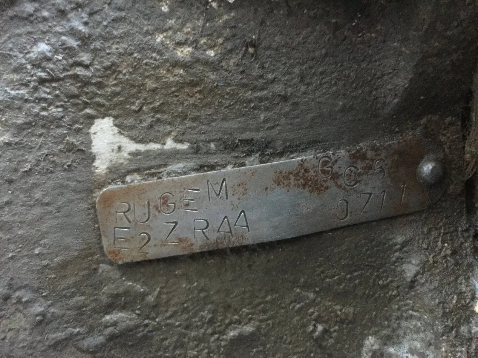

The car also came with an extra transmission, which I’ve researched to be a SROD 3+OD manual trans. I’ve read that these aren’t the greatest transmissions, but it came with everything I needed to run it, so I figured I’d run it while I replace some seals on the c4. I have to be honest, I doubt I’ll be going back to the c4. The srod may not be regarded as the greatest transmission, but even bone stock the performance gain kicks the crap out of the c4 in every way, with the added bonus of the OD for way better fuel mileage. Time will tell if it holds up.
Haven’t been able to find any specific info to decode this tag on the SROD. Any thoughts?

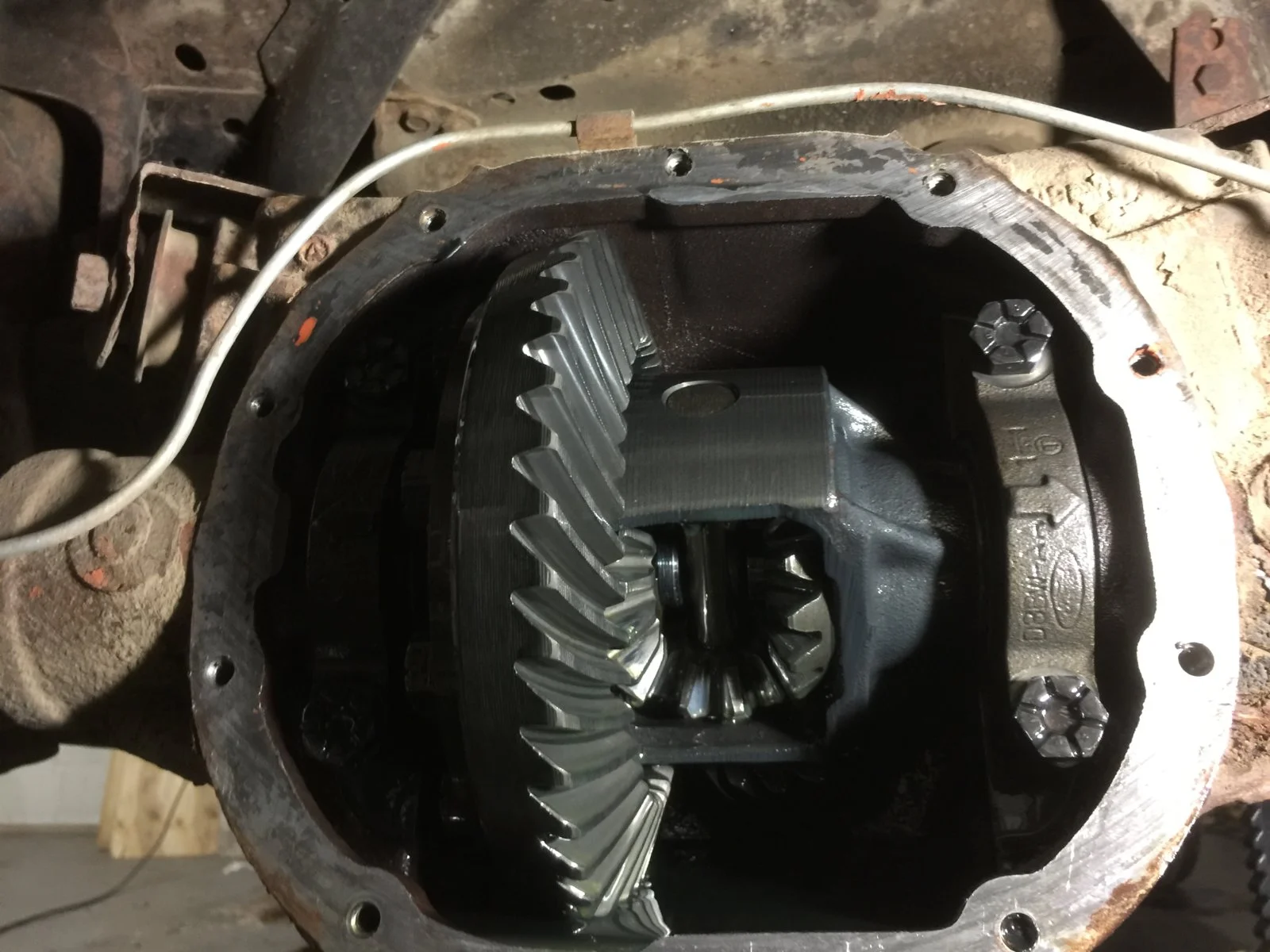

Does it have an 8.8 rear end or the 7.5"? If it's the 7.5" then it's tough to guess which will die first...the 7.5 or the SROD. You can probably pick up a T-5 pretty easily for $400-600. Just make sure it's a V-8 world class T5 and for a 87-93. 94-95 use a longer input shaft...you could use that, but you'd need the 94-95 bellhousing. 4 cylinder T5's are weak and have a STEEP first gear. Also, Ford and GM T5s are different. GM rotated theirs off to the side for some reason. T-5's are the stoutest either, but they'll hold a mild 302 especially if it's traction limited. :cool:

It’s for sure the 7.5” rear end, as I just swapped out the gearing to 3.45’s.
I’d like to go with an 8.8” rear, I’m just not sure if it will bring down the value of the car if I stray too far from the original setup. My intention is to restore it to the original Cobra look it came with, minus the hideous graphics. Just having a hard time finding a front bumper cover and hood and haven’t seen any aftermarket replacements that are a match. Also not familiar if there’s any other years that had the same setup on the front.

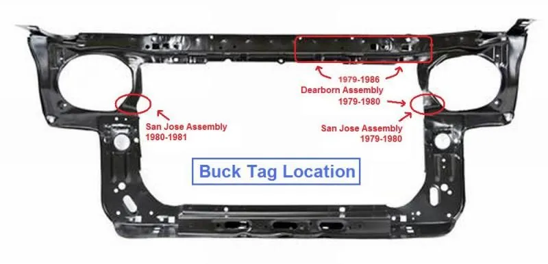

The door tag itself does not prove the car to be a Cobra. There are no codes on door tags and that exclusive to Cobras. You will need the buck tag to prove it to be a Cobra.

Int Trim - WA = cloth and vinyl Recaro seating (W), Black interior trim color (A)

Transmission Tag
RUGEM = 1982-83 5.0L Tremec SROD 4-speed manual transmission
GC6 = built on July 6th, 1982
E2ZRAA = manual transmission (R) originally engineered for 1982 (E2) Mustang (Z), release level AA
0711 = serial #0711

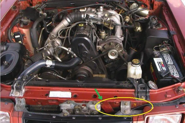

I'm not sure but look for a tag behind the headlight or someplace on the left side of the radiator support
I had a real good look in this location and surrounding areas with no luck. Pretty sure I found the spot where they were mounted, but all that’s left is a rusty screw or rivet hole and an outline of what looks like the two corners of the tags. I’ll be completely tearing the car down over the winter, so maybe I’ll come across them in the process.
