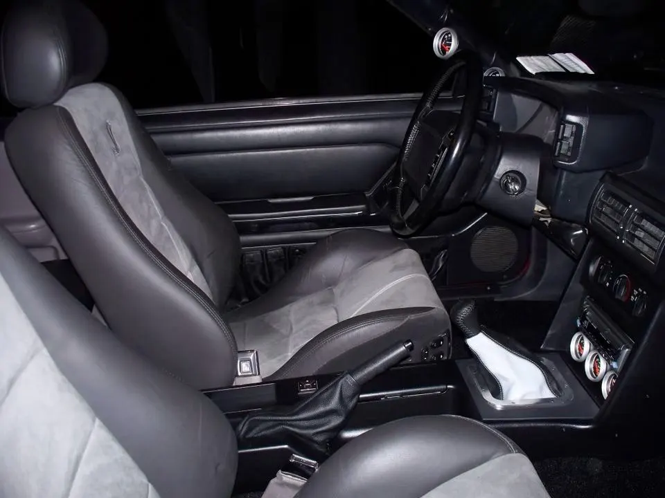

i'm a fox guy but i stumbled onto this thread and i figured i could lend some advice, being that i just did this to my own interior... and to answer your question: humidity has a lot to do with how a paint job turns out
for what it's worth, i just painted my black and grey dash and plastics to all black using SEM products... they absolutely cannot be beat for painting vinyl and hard plastics
i washed the parts with (grease fighting) dish soap in warm water, dried them, wiped them own with a good grease and wax remover, wiped them down with tack cloth, sprayed them with SEM plastic prep spray, spayed them with SEM adhesion promoter, and then painted them with SEM color coat "Landau Black"
the key to a good finish is in the prep work, don't skip steps, don't touch anything with bare fingers once it's been washed/degreased (latex gloves help) as finger prints are greasy, and allow ample drying time before you try reinstalling anything (i.e at least two full days)
here's where i ordered my paints and supplies Auto Body Toolmart
good luck and i hope i helped!
Chris
here's a bad pic of my interior 98% finished:
