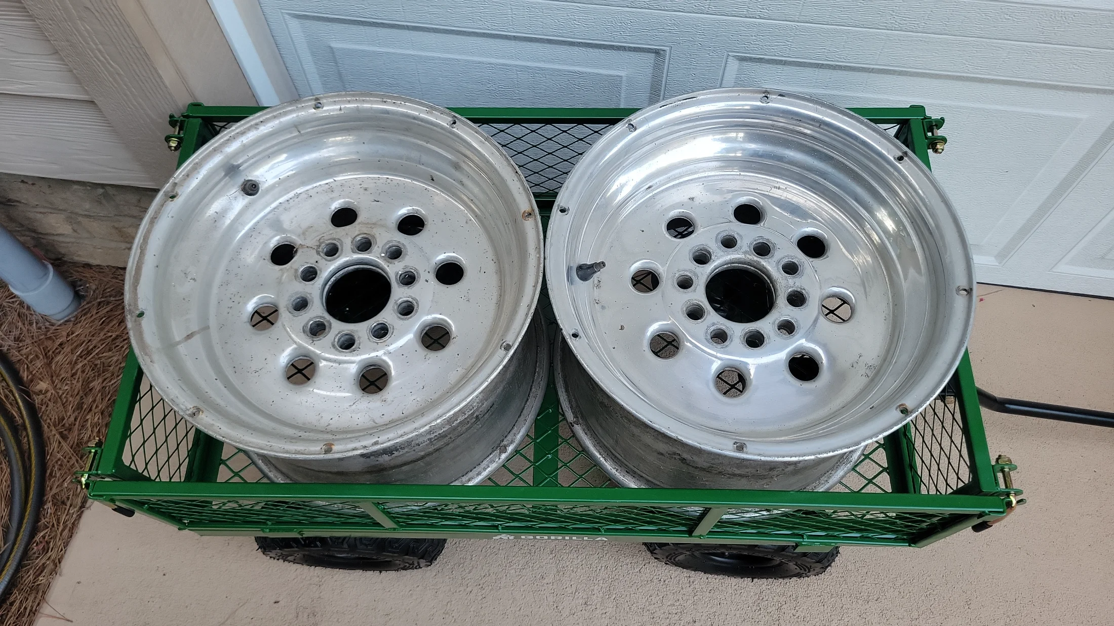

Picked these up today for $375. 15x10, 6.5" BS. Ain't pretty, but should fit after a little banjo bolt clearancing. I've heard stiff wall slicks are best for Manual Transmissions. True?

15x10 weld, 6.5" bs, MT et drag 26x10x15. If you were closer, I have a set of the slicks sitting here I used on the Grench.

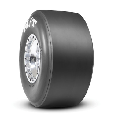

M/T recommends a stiff wall slick for stick cars, heavier cars, and high powered cars. That's what I got for Father Time, because it'll make 1100 rwhp. On Black Jack, I'm actually thinking soft sidewall is the way to go. Black Jack may eventually push 500 rwhp, but right now it's making well less than 400rwhp. And its starting line ratio is very tall; 2.66 * 3.73 = 9.92.
That tall, I think winding the RPM way up and very aggressively releasing or even dumping the clutch is preferred. Soft walls absorb shock, and recover better from hazing/spin. Plus, the softwall is a true 15x26, whereas the stiff wall is 15x26 but has a reported OD of 26.5". So, the shorter tire is slightly better gearing in my application.
Thoughts?

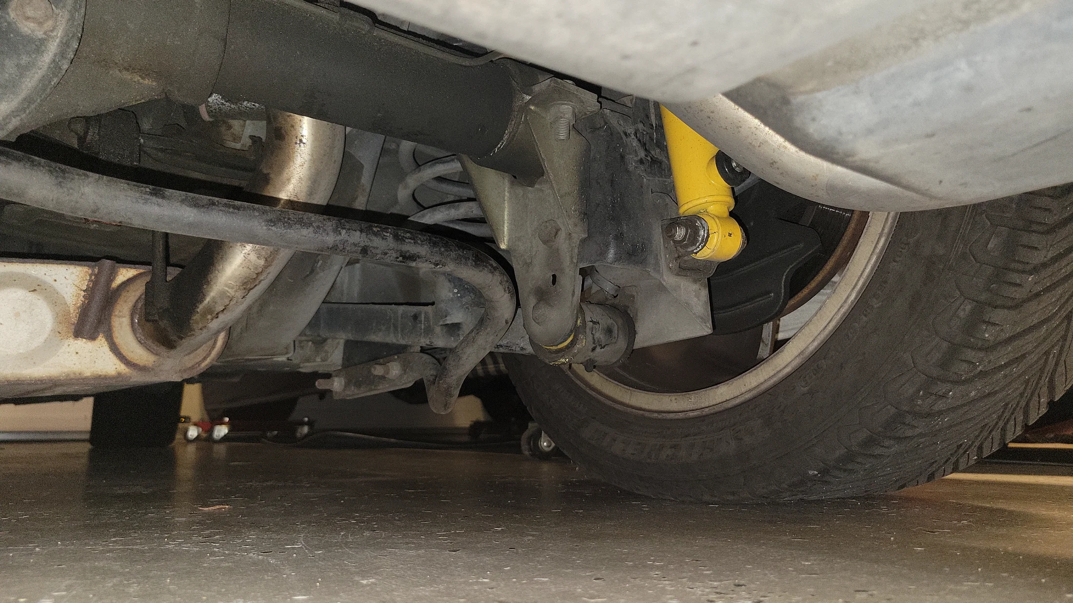

I noticed last week that black jack's rear is torque steering. When on the throttle, I have to correct the steer by maybe 5 degrees in the steering wheel, and when I get back out of it, I have to go back the other way. So, I climbed under the car and looked at everything in the suspension. The only obvious issue was that the LCA bushings are shot, and some casual readings tonight have confirmed this as a cause of the rear steer. Furthermore, I can see essentially witness marks that the bushings are moving around in there.
So, instead of just ordering bushings, I decided on an upgrade. BJ sits either dead even or with a slight reverse rake. So, I ordered the height adjustable MM Extreme-Duty LCAs.
They're apparently good for 600hp drag slick launches, MM claims that the spherical bushings are easier on torque boxes because they allow better articulation, and they provide the height adjustability I need to help clear expanding slicks and even for corner balancing for autocross. Plus, with the extra space back there, I plan to soften the compression on the Konis to improve ride while the extra height should keep me off the bump stops.

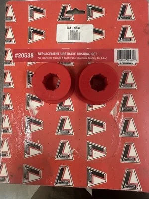

Canceled my order on the MM LCAs for the time being. I thought I'd be able to swap them in place of the Lakewood LCAs while keeping the brackets that drop the LCA to axle mounting bolt hole. That's not so, however, as I was able to confirm that the stock bolt is a 12mm bolt, and the lakewoods are a 1/2" bolt. I don't want to drill on brand new $500 MM LCAs. There's also the matter of whether the MMs would be the same width as the brackets.
I like the improvement in traction the dropped mounts provide both in a straight line & in autocross, and I attribute my 1.83 60' on stock sized all season goodyear tires to them. Going back to the stock mounts with the MMs and cranking up the height might achieve the same IC & AS result, but there's no guarantee it'd work out the same with the rear end up higher.
So, I'm opting instead to just attemot to find the right Bushings, Lakewood PN 20538, which have been discontinued.
I got a set off of ebay, and need 1 more set. Alternatively, I'm already having the rear axle tubes welded up, and I could get Team-Z's relocation brackets welded up at the same time, then do the MM LCAs, but at that point, I'll probably be in for a grand, instead of just another $40 set of bushings.
I don't suppose any of you have a set of these bushings?
