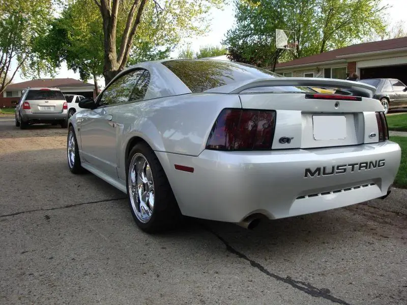

BurningRubber said:
Here are mine... Probaly 3 solid coats of transparent black, 1 coat clear.
Did them in a hurry, right one came out smoother but unless you are right up on it you cannot tell.
I also masked the reverse light off, I like how it came out.

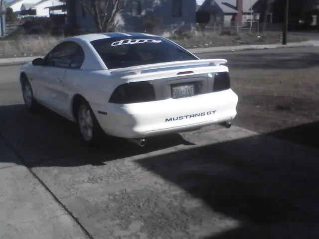

wow i musta put it on really thick .. this is my car with 3 REALLY thick coats! and 3 coats of clear... i spent about 6 hours on em doing prep sanding.. then paint wetsanding, rubbing compound, polishing compound, waxed them a buncha times these things look like glass..
these were euro lights that were on when i bought the car (dealership put em on)
but like i said, i almost get hit about once every 2 weeks from how dark they are.

Dang man, you did put alot into it.
I just cleaned the lights off real well and spray away, lol. I made sure the coats were kind of thin, I had the lights on my Jeep really dark like yours and experienced the same problem with other vehicles not seeing them too well.

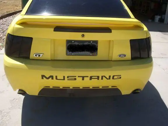

Sorry it took so long for the pics I could nt find my camera cable. This is one coat of Gloss Black Spray paint no sanding. They are very dark. The light is noticeable during the day obviously its not going to be 100% and at night there are no problems. I have been pulled over with these lights in but neither of the times had the cop even mentioned. I got pulled over in Colorado and in Wyoming btw.
