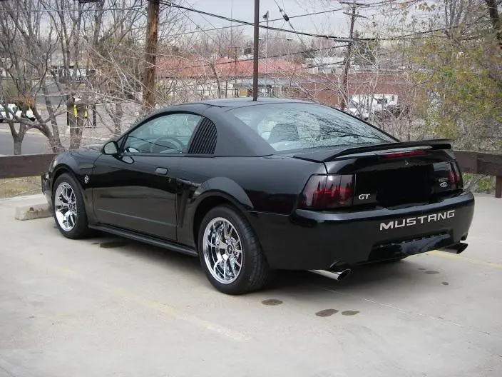

You can do window tint, but the stuff you want is Gila Glare Control Window Film (Smoke color). You can get a large roll of it at Home Depot or Lowes for less than $20. (I'm still livin off the roll I bought a couple years ago). The part number is CS78 and it comes in an orange box. It's actually considered static film, but I've had no issue with this stuff sticking to taillights (and even headlights) through rainstorms, car washes, etc. You CAN peel it off when you want to, but it's not going to just fall off itself.
This stuff is thicker than stardard window tint, therefore it's a bit easier to work with. Make a template out of paper, then trace that onto the backing on the tint. Cut it out, and apply to a clean and wet (with soapy water) taillight. Use a towel to help work out any bubbles (not much of an issue on the taillights, especially the inner 2 pieces), then just let it sit for a couple of hours to dry.
Oh, another tip - when creating the templates, you just need to make the three pieces for one side, then flip em over for the other side.
See my latest tint work in the attached pics.
