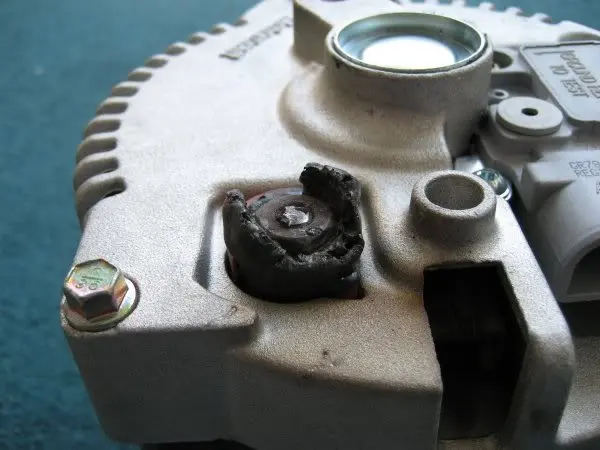

Jul 7, 2007
#37
  • Jul 7, 2007
  • #37
Did it look anything like this?

#38
  • Jul 7, 2007
  • #38
No, mine is blowing internally. actually, the palladiums were rebuilt new ones.

#40
  • Jul 7, 2007
  • #40
What happened to that one?
