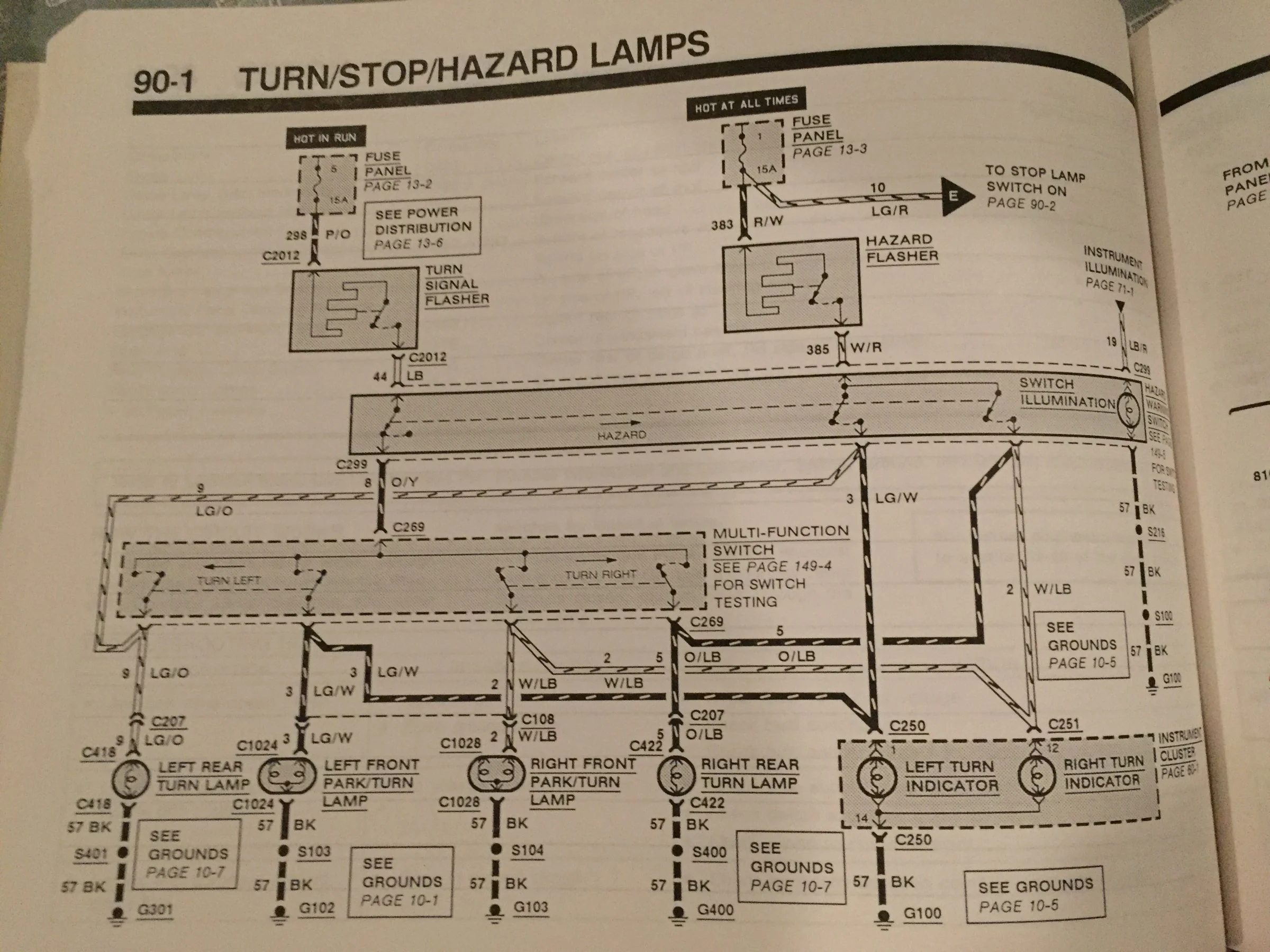

My magic book has these wire diagrams

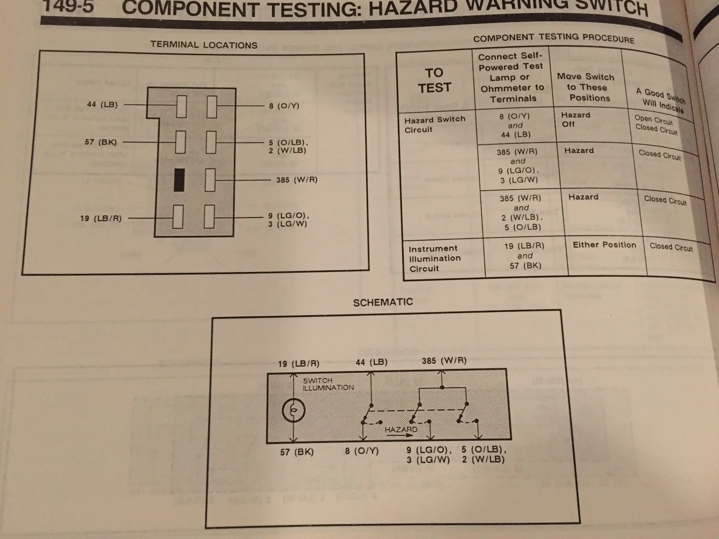

Here's pinout and testing of Hazard switch to confirm proper operation

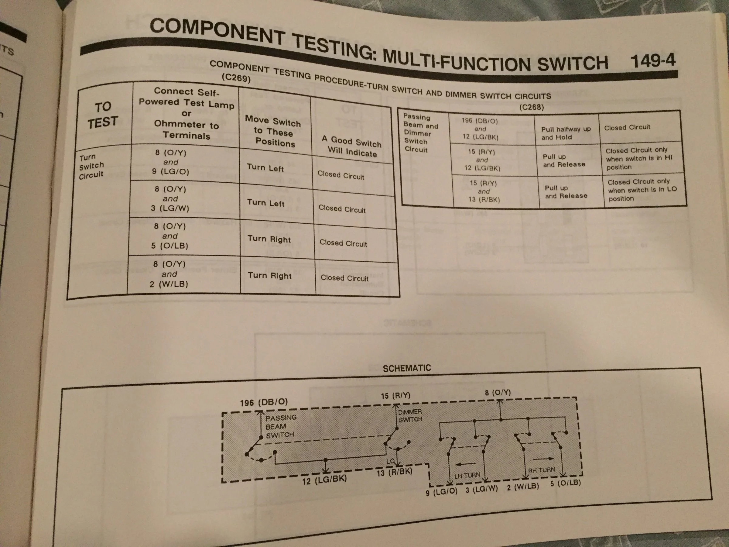

And multi function switch testing with regards to turn signal. I think that's all the info I can provide

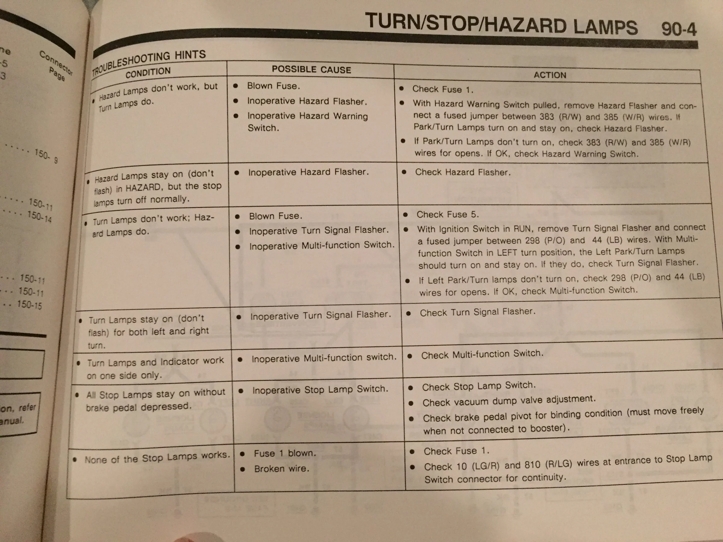

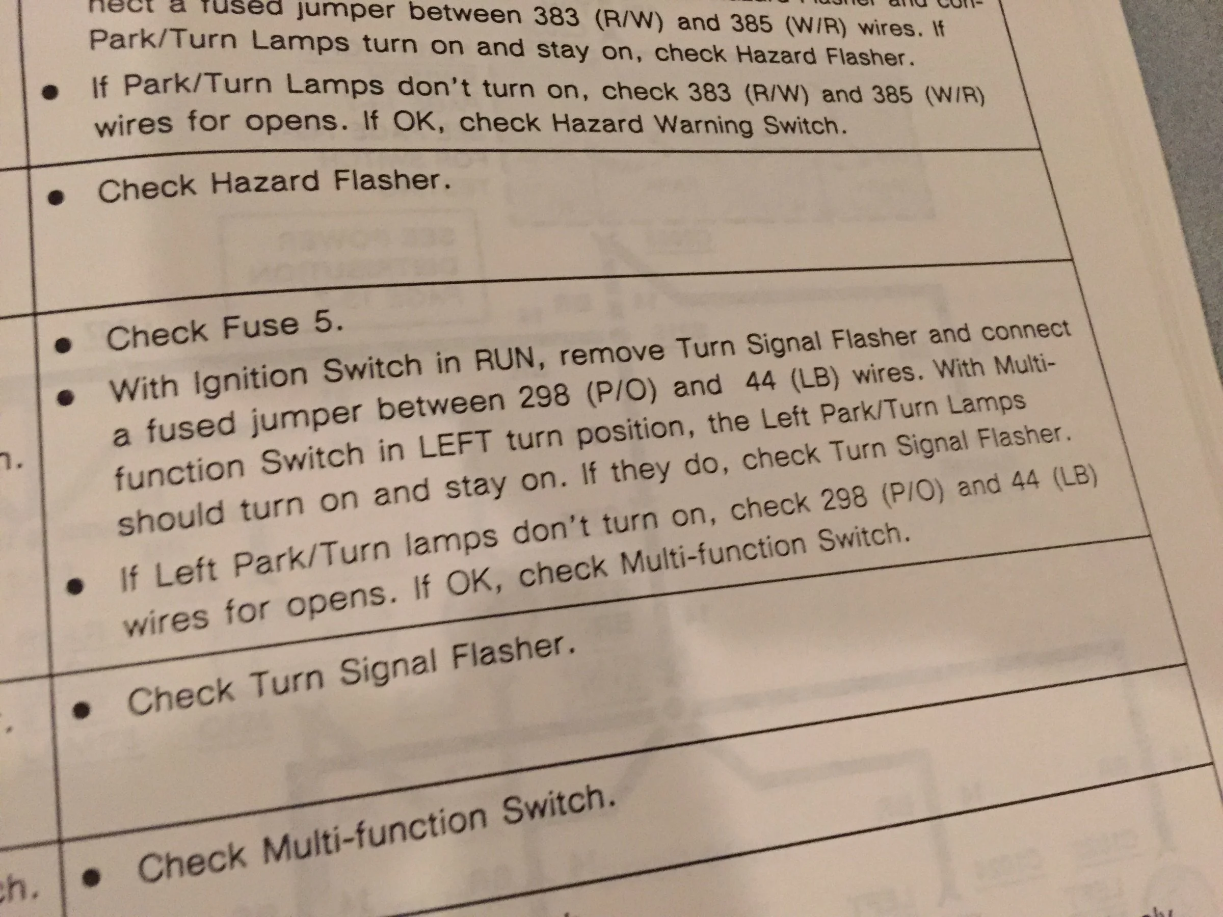

Try jumping out the turn signal flasher with a fused wire

Awesome! I saved the pics, I will do the jump wire in the morning. Will let you know, you've given me more info in 20 mins than 4 hours of searching on Google.
