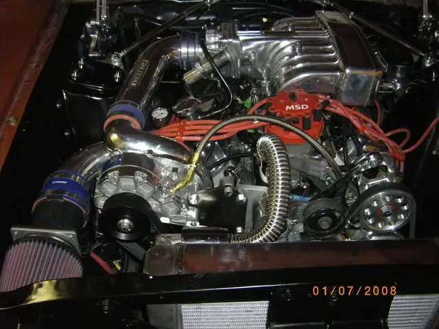

I came across an 89' or 90' mustang motor stroked to a 331 with a blower on it. It's putting out 500hp. The blower is on the passengers side and sticks out pretty far. Think that motor would have enough clearance to be dropped into my 67'?
I have a Vortech supercharger on my 68. It is a tight fit but you can do it without toooooo many mods. You will need a custom inlet pipe, you may have clearance problems with the alternator on the strut rod, modify your radiator inlet and so on. Here is a pic.
