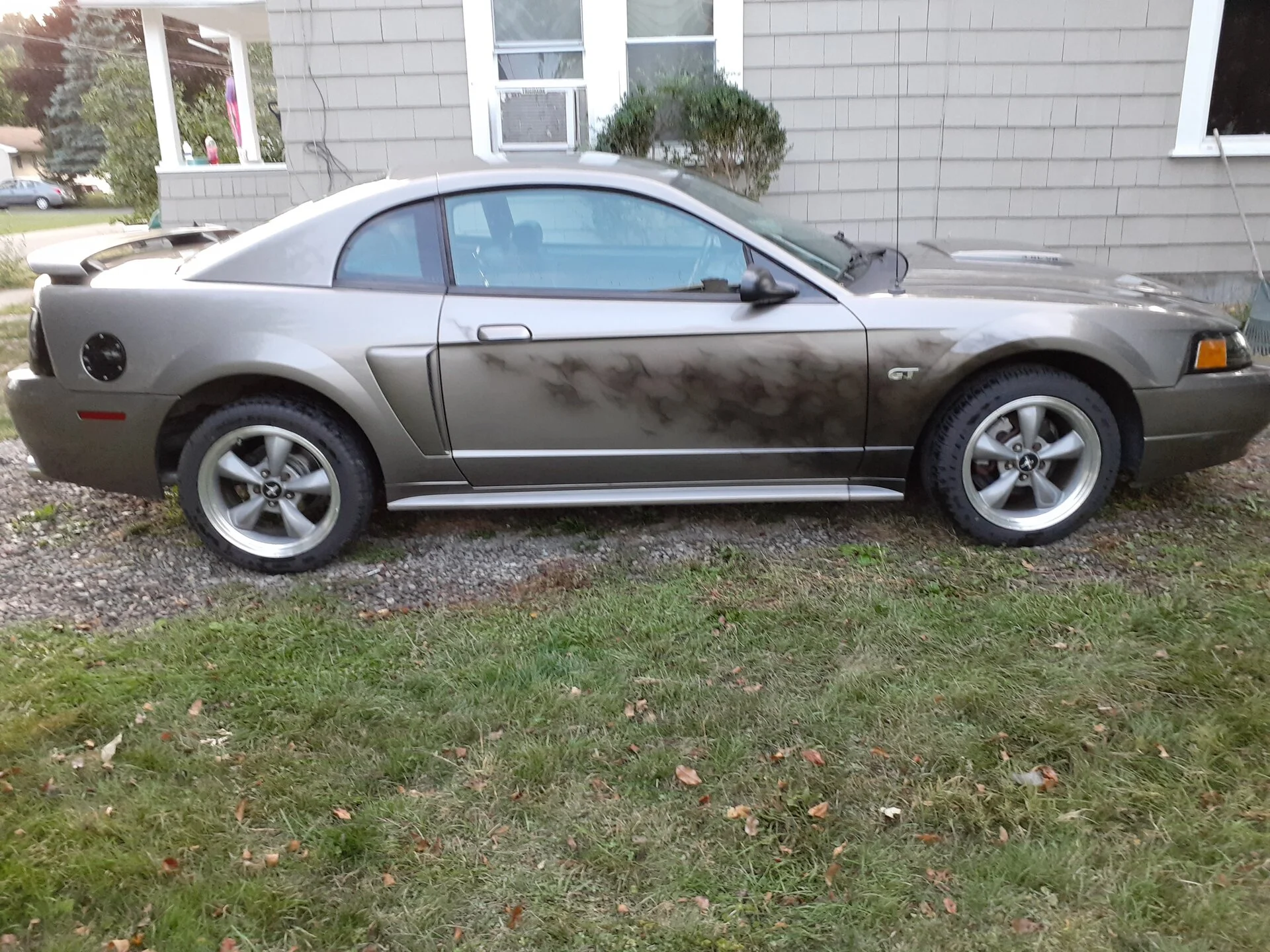

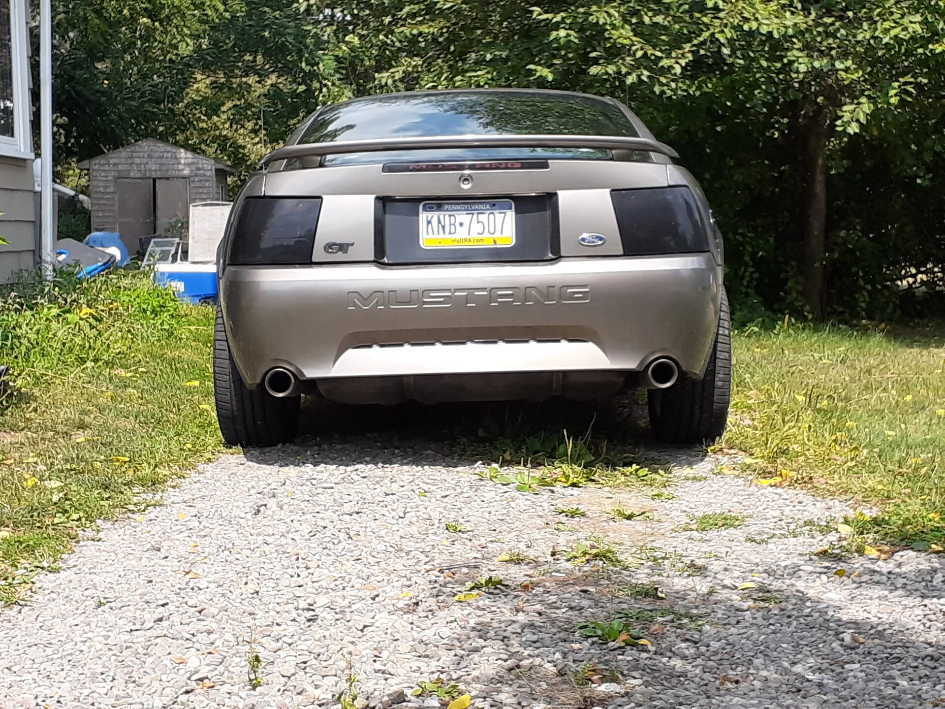

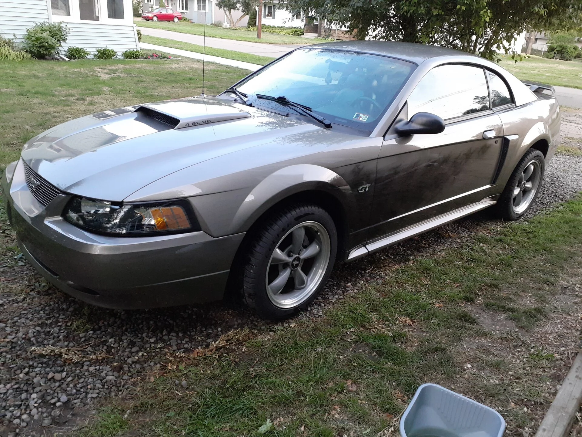

These are the pics of the stang. IT has air brushed flames on both doors
