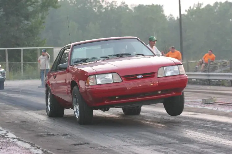

This is flex with subframe connectors welded on.....:nice:
