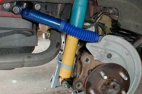

i wouldn't say they helped THAT much, not enought to merit a "Wow" at least. but they did make a small improvement i'd say and that's in addition to the MM LCA's i already have on the car. some say you can run without the quads if you've got aftermarket LCA's (rear Lower Control Arms) but call me crazy i noticed more of a difference (traction-wise) with the replacement of my blown quads over the replacement of the stock LCA's
the blue ones going sideways are the quad-shocks. these are aftermarket, stocks are black with no boots
to check them just take them off (15 and 18mm i believe) and compress them. if you can compress them with 1 finger and they don't move back they're done. i went with KYB's from stangsuspension.com, $38 each.
