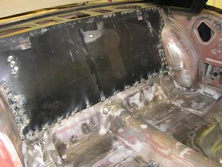

It's coming alon slowly but surely....
the only places I've had to remove the paint from was the engine bay and the rear floorboards...everything else was replaced...but for those two areas I used a grinder with a wire wheel brush. It works good but you'll need several brushes b/c you can go through them in a hurry...especially if your surface is not flat
