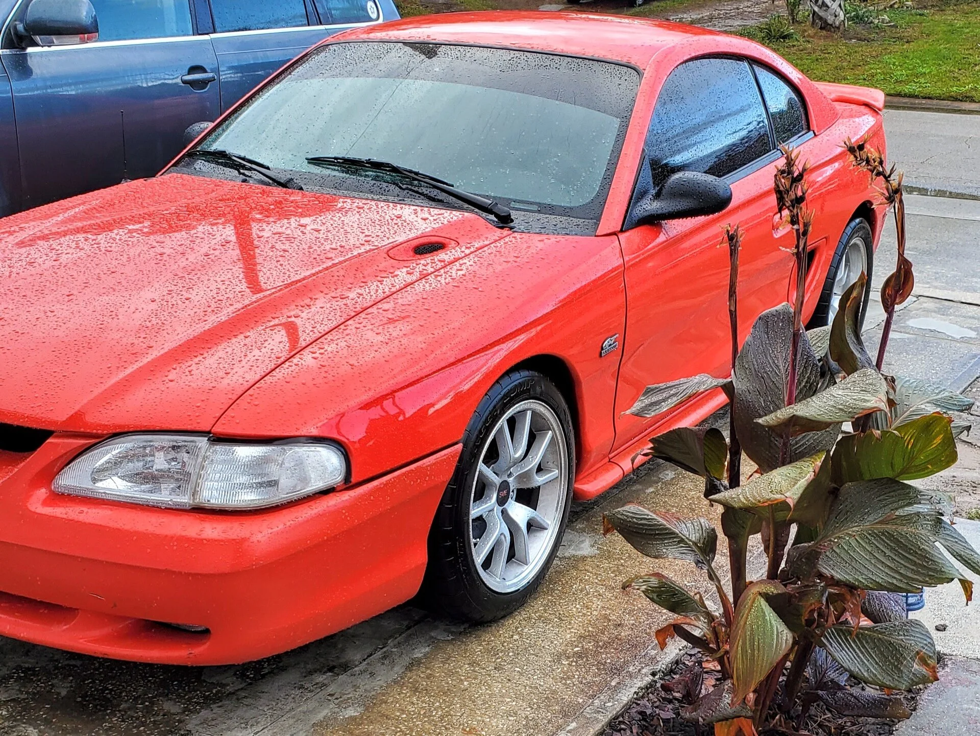

Have a 94 Mustang GT.. at WOT bogs completely falls on its face @3300rpms,. New plugs, wires, cap, rotor, tps, act,sensor ,ect sensor,fuel filter. Drive great at anything but wide open throttle

What RPM are you seeing when this happends?

3300 under load...4100 off load (reving)

Possibly fuel pump weak, have you checked pressure?
Checked for codes?

I have. I have to premenstrual 2x koeo to get it at 40psi... But I have just found some older threads...with exactly the same issues...ordered fuel pump last night walbro 255lph

I have. I have to prime 2x koeo to get it at 40psi... But I have just found some older threads...with exactly the same issues...ordered fuel pump last night walbro 255lph
I have 2 prime the pump 2x to get to 40psi*

That's a hint probably on the right track
Nice stang btw.

thanks....I'll keep you posted

fuel pump came today....another question..could a bad 02 sensor cause the same problem? falling on its face? the reason I'm asking is because within seconds of a cold start my engine bay gets hot...even my upper gets hot ...like HOT burn you within minutes of idling

I don't think so, that would trigger a cel I would imagine, but that is only my thoughts, not to be confused with any real mechanical experience

Nice car! Hopefully the fuel pump fixes your issue.
