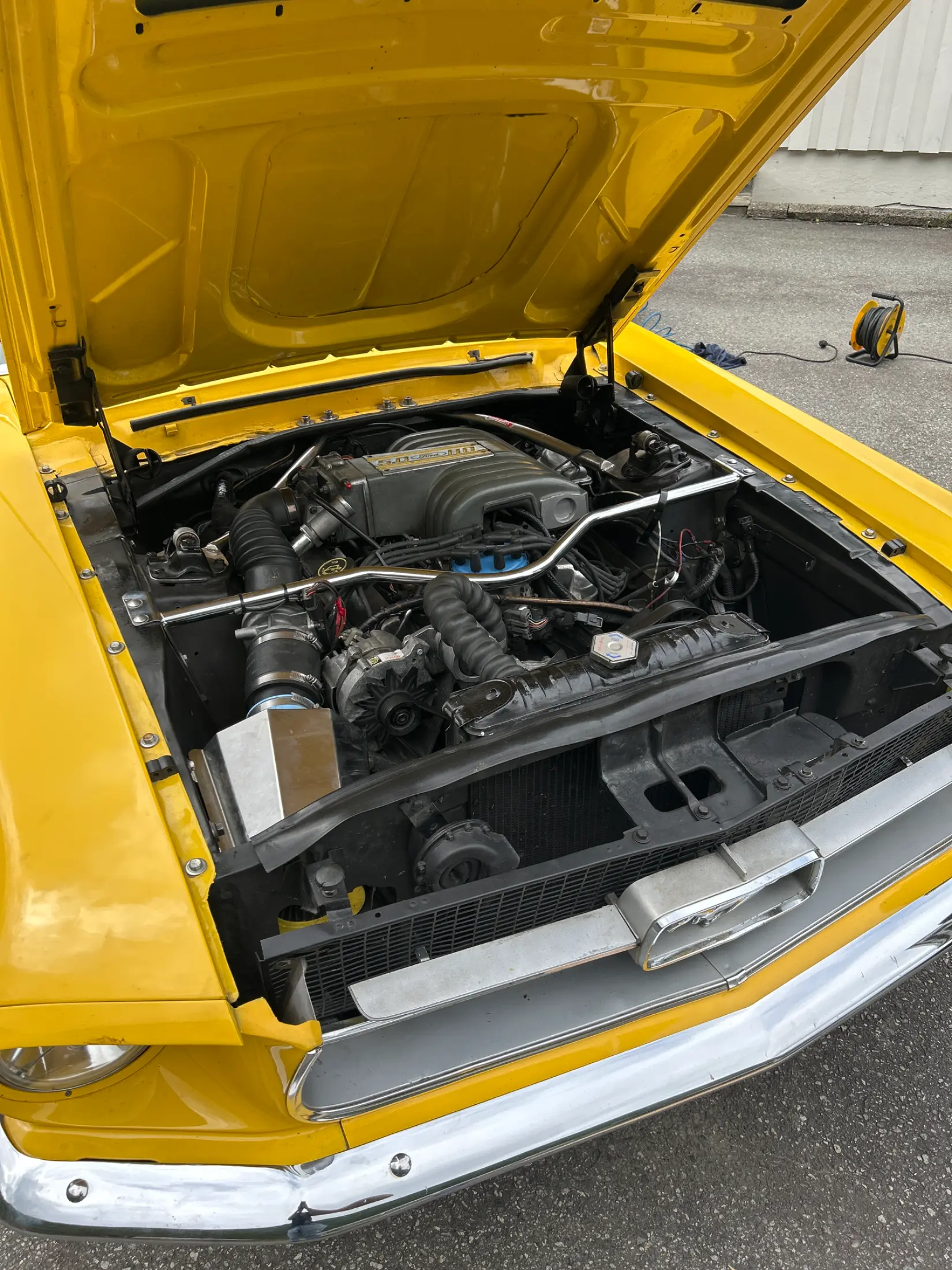

Hi, I have a 67 Mustang with a 5.0 HO 90 engine and T5 trans.
It have been down on power fore a while but ran smoode still.
Recently it started to bog and pop from the exhaust over half throttle.
I have checked a bunch of things and replaced parts with some extras I had laying around.
TPS is fine.
MAF is fine.
O2’s are fine.
Fuses are fine.
Timing is fine.
Fuel pressure is fine.
No vacuum leaks.
Replaced fuel pump.
Replaced fuel regulator.
Replaced plugs, rotor and cap 1/2 a year ago.
Replaced fuel filter 1 year ago.
Replaced tank 3 years ago.
After trying and fault finding a bunch of things I replaced the ECU with one I hade laying around, but that’s from a 88 crown vic.
It ran great and was strong for about 15min than it started to bog and pop in the exhaust and was down on power.
Checked the connections and ground to the ECU and cleaned them up but no luck.
Swaped the correct ECU backs in and still the same problems.
Have anyone else had similar problems?
All tips would be appreciated.
-Sander
Crown Vic ECU will not work so quit that.
You need to check for codes. My guess is you do not have a check engine light (CEL) with this being a swap. Even if you do they will only illuminate if you have emissions related codes so you could have codes and the CEL would not come on. Go here to learn how to pull codes.
If you do this procedure and you cannot get it to dump any codes the it’s most likely the ECU needs to be sent off for repair. At a minimum you should get a Code 11 when doing the KOEO dump and if you do then at a minimum you should get a Code 11 for the KOER dump. Failure to get that typically means the ECU needs repair.
