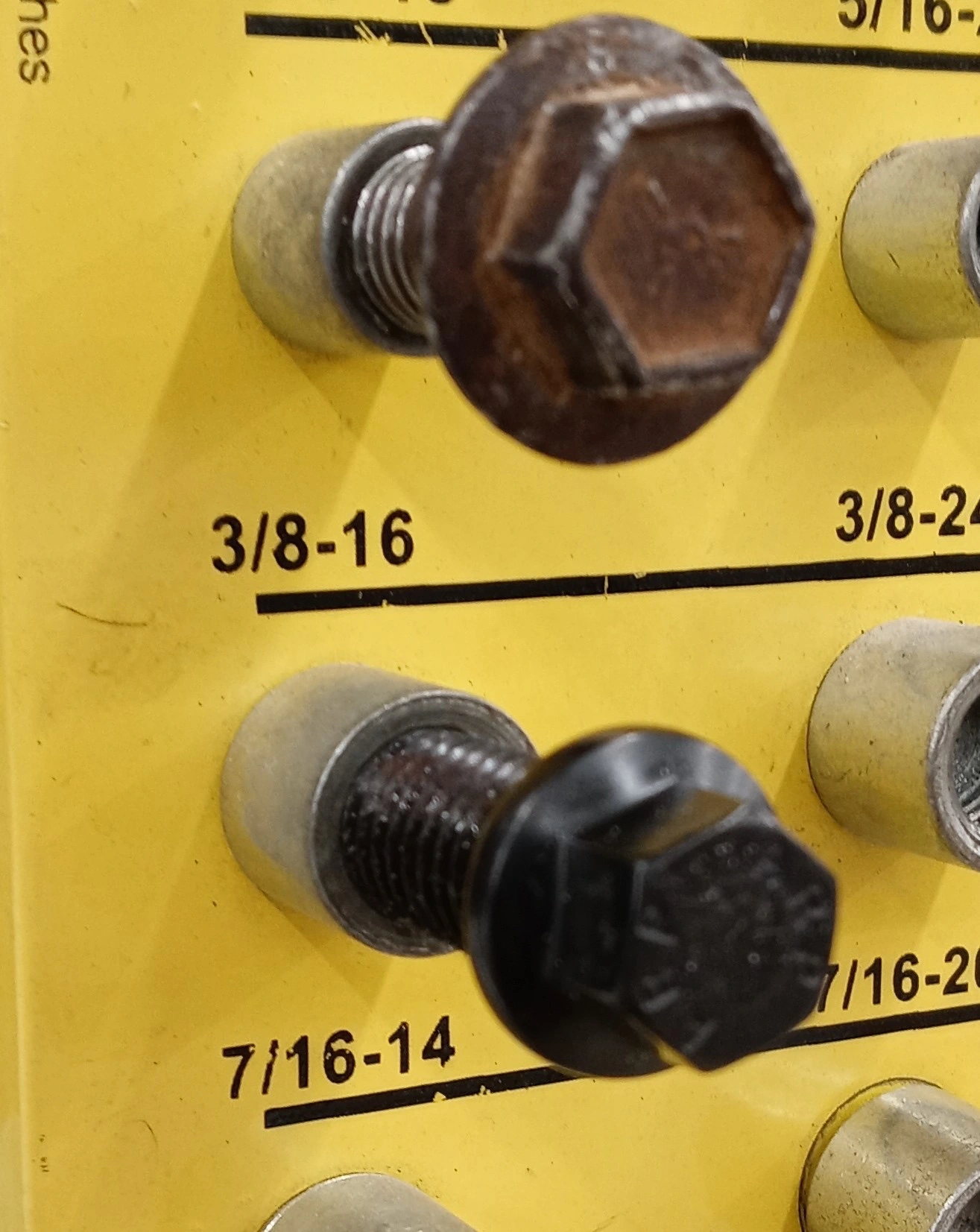

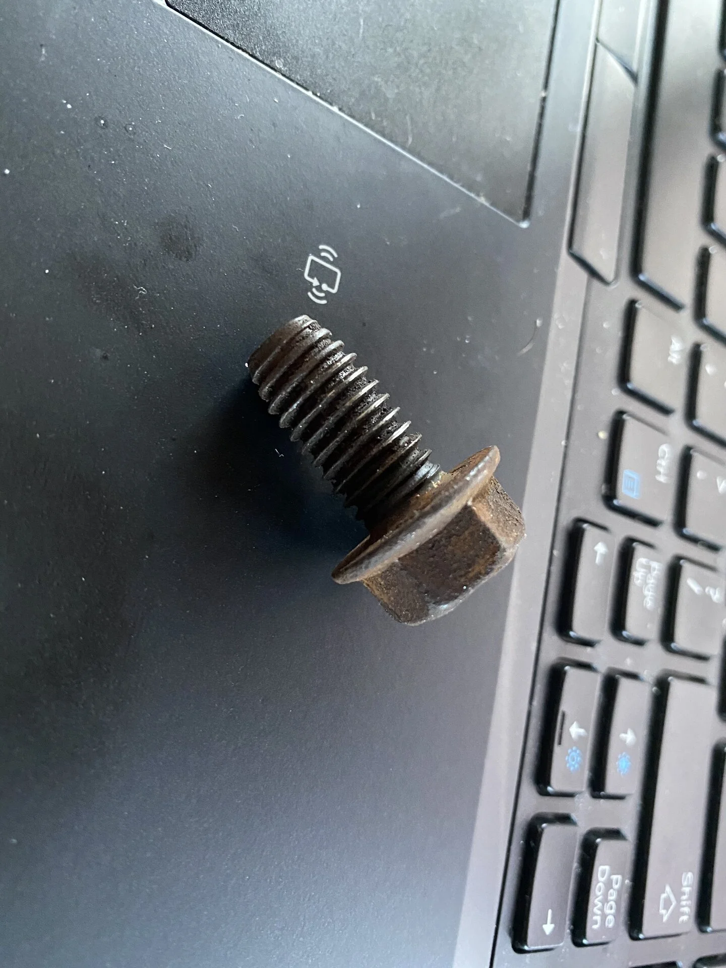

What’s the correct bolt size .....motor mounts bolts 7/16 14 .75 or 1/2 13 .75.......

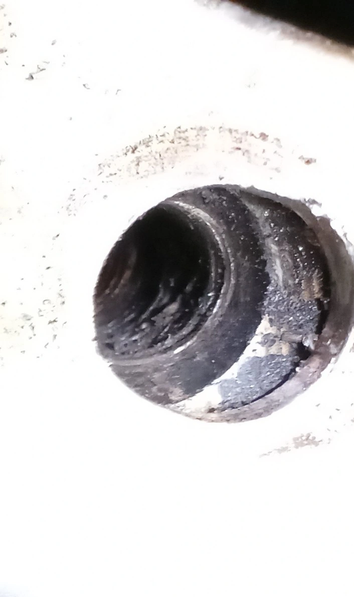

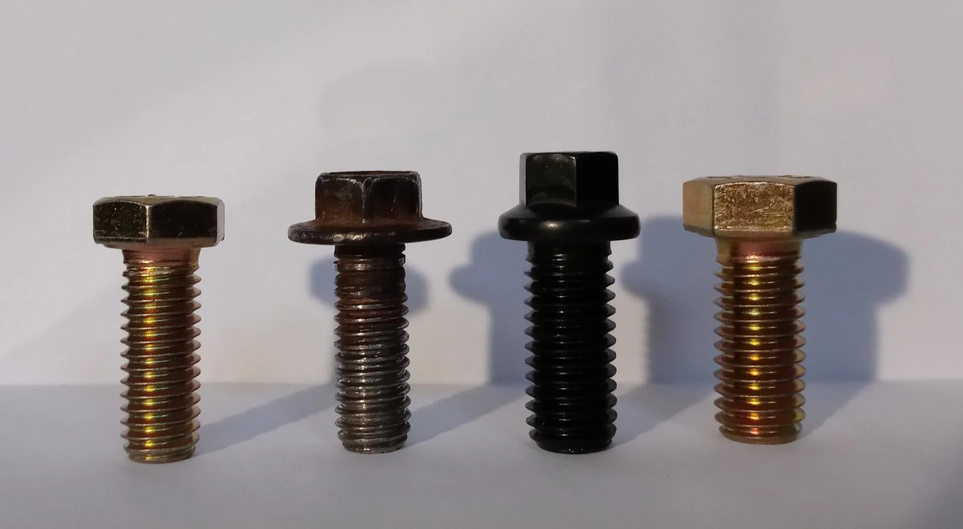

Trick question so why are these ARP bolts bigger ..... somethings weird I got to do a little bit more research ....The 7/16 was sitting in a loose hole stripped.......

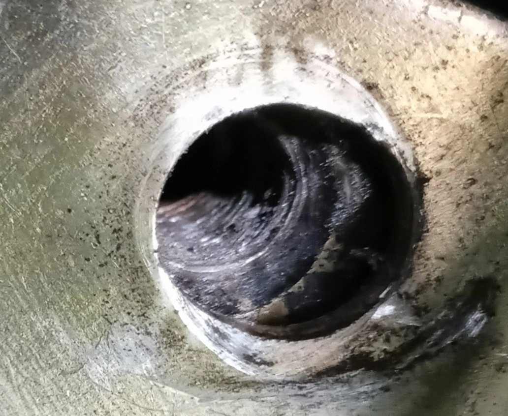

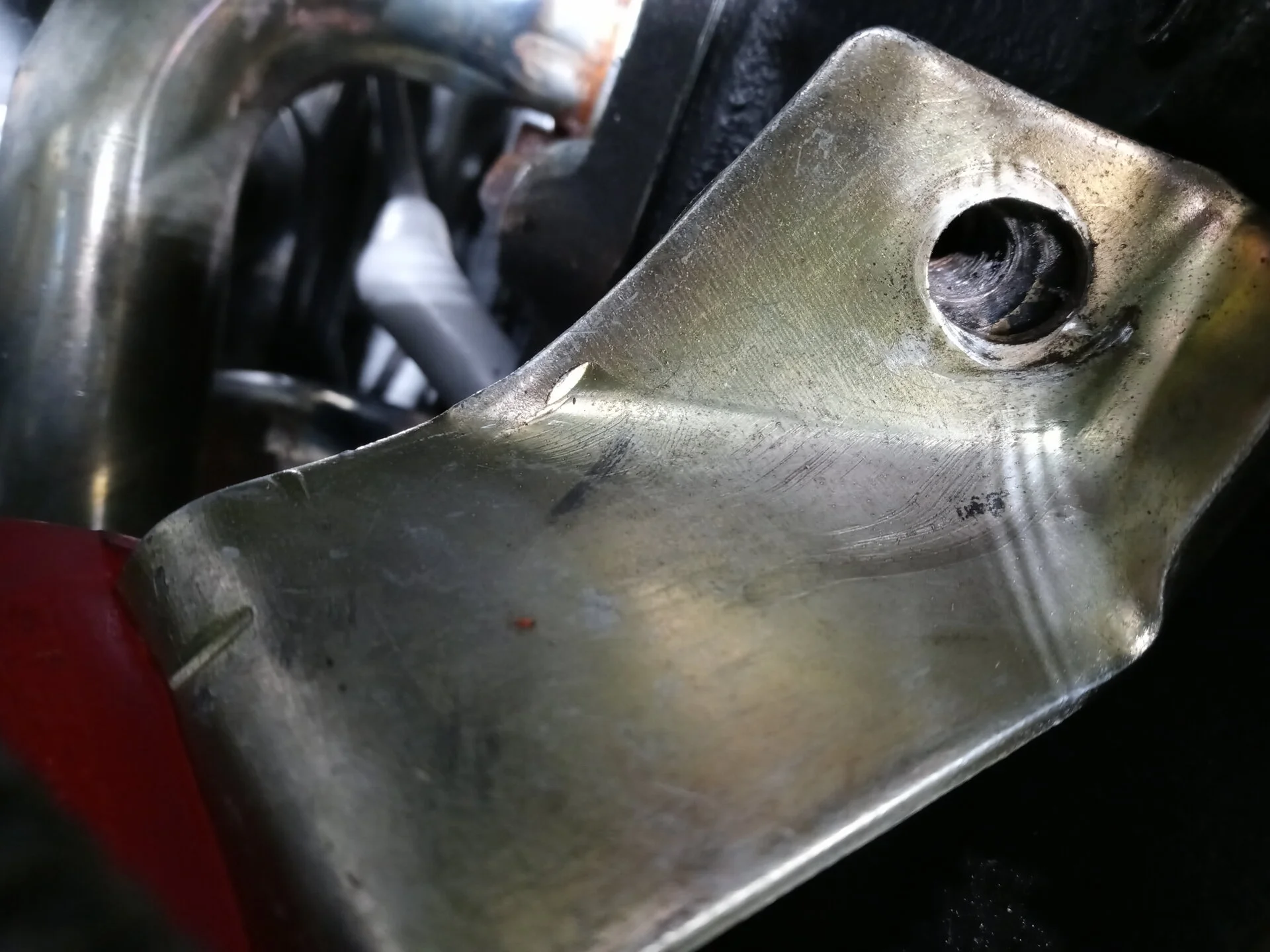

The ARP was the correct bolt..... The other bolt use the same size socket but the shank was smaller it was stuck in my engine for about 15 years ? So I’m going to chase the hole and see if the ARP will do the job......
