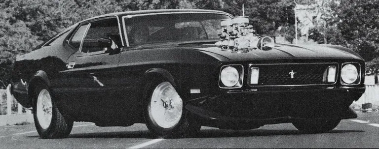

That’ll Fix it -
Instant No Boredom…. :D
