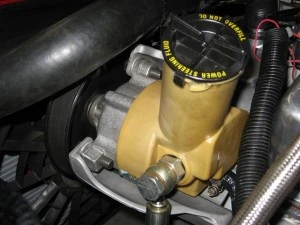

Maybe I can use the words C2 power Steering Pump in the 1965-1973 without breaking any rules. The "Small Block Ford Engine" that I will be using in my 1965 Mustang will have the M II C2 pump attached. Has anyone used this pump with the Borgeson Power Steering upgrade Kit part #999020 ?
I've attached a picture of the pump for Identification purposes

Edited: Let me rephrase that. I assume so, however I have not researched the C2 pump from the Foxbody angle. I did from the F150 direction because I picked it as a real power steering box vehicle with a C2 pump. I have not researched the Foxbody R & P pressure and flow requirements. It may be as easy as looking up the mid '70s F150 PS pump (C2) and the '89 Mustang PS pump online parts shopping and if the part numbers are the same....
