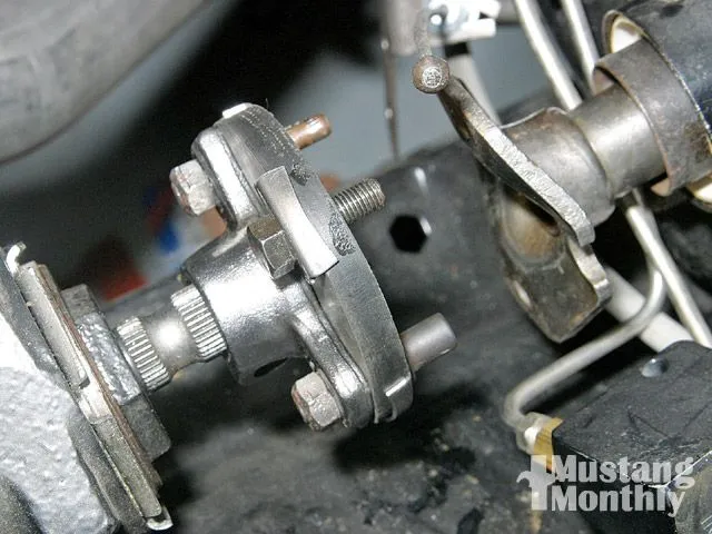

I came across a post regarding the Borgeson Steering box. It seems there are several that are happy with the stock steering set up using this box.
In my case all my tie rods are shot, the PS steering hoses are also shot. The pump was working. Hopefully the power steering control value is ok and I can rebuild the cylinder if needed.
One problem is the stud on the control valve shaft is very worn, can this be rebuilt? Sorry if I have the wrong name for that threaded lug.
With added steering radius, possible bump steer and other issues with racks, I am leaning toward retaining the original steering system.
If anyone can help with my questions and where best to get the bogeson box, please reply.

if you get the borgeson power steering box you can dump the stock power steering crap, the control valve, the power ram, etc. and use a manual steering drag link. you can keep your stock power steering pump as i recall though as long as it is working ok.
In my case all my tie rods are shot, the PS steering hoses are also shot. The pump was working. Hopefully the power steering control valve is ok and I can rebuild the cylinder if needed.
1) The tie rod ends would need top be replaces to use the Borgeson.
2) The valve is not hard to rebuild.
3) The boot on the stud end can be replaced, and the seal on the shaft can be replaced. If the rod is smooth and straight, that is.
4) The ball stud sticking out of the valve gets thrown away, there's a new one in the rebuild kit.

I've installed the Borgeson box... it's pretty much a bolt in, but you do have to buy the steering rod and rag joint as discussed earlier...
I can't speak to turn radius just yet, but I drilled the Borgeson dude pretty good before purchasing and he was adamant that there are no downsides to this upgrade. The mounting bracket seems well made.
