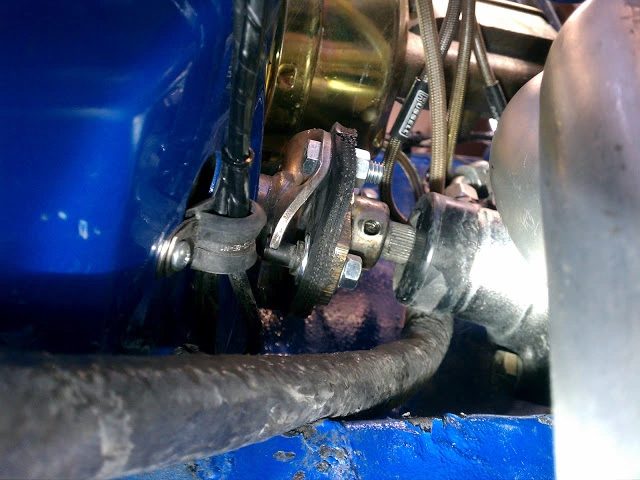

This can't be right? If I loosen either end and try to push the joint closed, the elasticity of the disc just pushes them apart again and pops the steering wheel out of the column. Should there be a bearing at the bottom of the column to keep the shaft from pulling out? This is a project car a previous mechanic worked on and no longer works there, and all manuals are gone. This 66 has been here for years and I'm now finishing it up. So I'm kinda lost. Thanks.

there would have to be a bearing or some kind of retainer for 65-67 long shaft
as the taper at the top has to have something to keep it stationary
the bearing i think goes at the botom of the column tube 68-69
has a c clip that keeps the shaft in place
