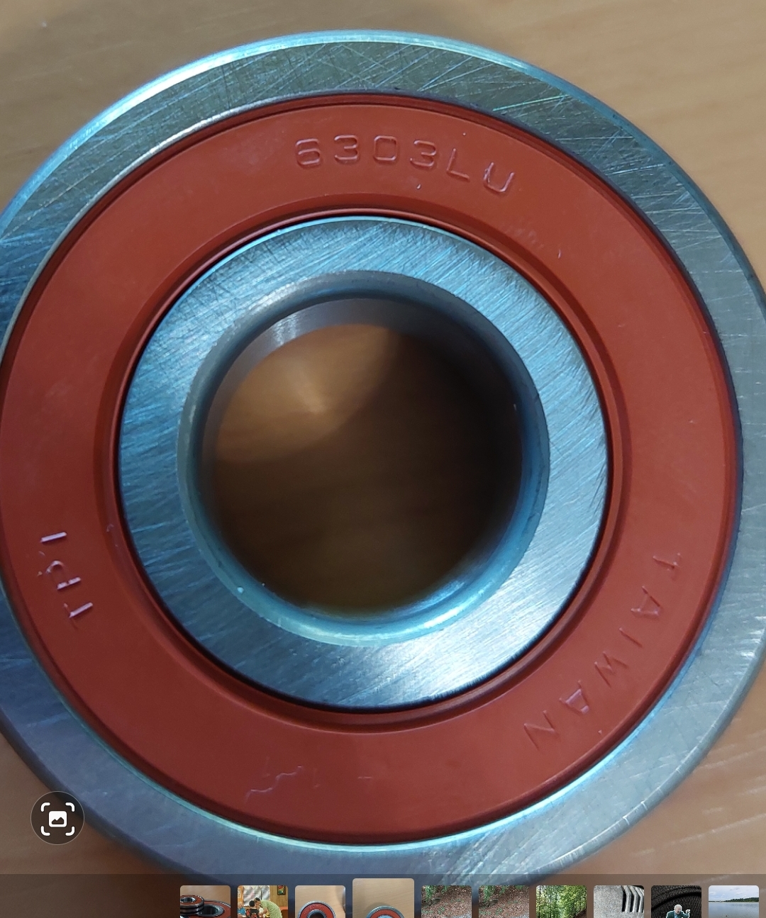

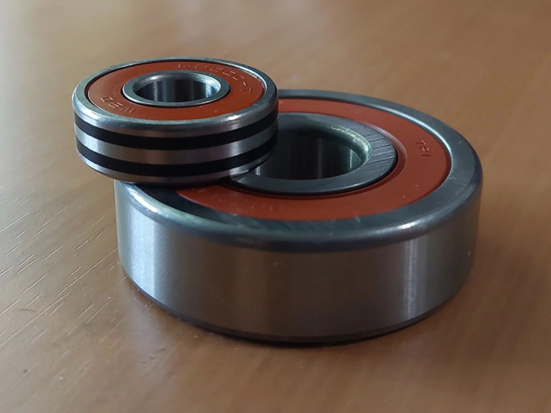

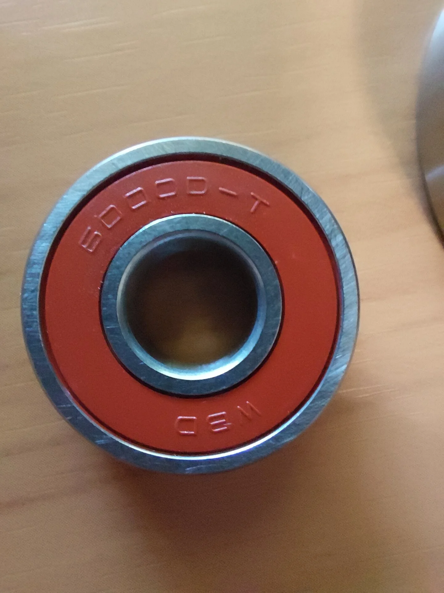

Thanks. The town i live near is half dead with no decent resources for anything. We do however have a good second generation alternator-starter rebuild shop. Looks like a shop i would go in as a child. And it actually was there before me. I stopped in and the owner (the only employee) who i know sold me both bearings. He said if it's a Ford 3G these are it. So I'm going to try them. If not I'll go from there.
Hope you didn't throw away the 3G case and parts. Wish i had an extra to fool with.

The last (and hopefully last) alternator I rebuilt was not a 3G, and the bearings were part of a kit.
I hope that guy sticks around for a long time.
