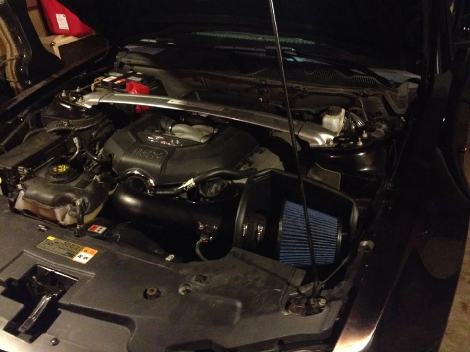

Been repairing/upgrading suspension so that the car will be able to handle the engine intake, exhaust, and tune upgrades I will be making. Here is a picture of the first intake upgrade: SR Performance CAI. I actually think I had more trouble installing this than the rear LCAs simply because of a lack of room.
It is quite a bit like the BBK CAI from what I hear- it even whistles at a certain RPM range, so it is probably contracted by American Muslce to BBK. I went with it because it gets the job done, it is Ford engine blue (like the coil covers will be once I install the Boss intake manifold), and it doesn't require a tune as the MAS inserts into the tube.
